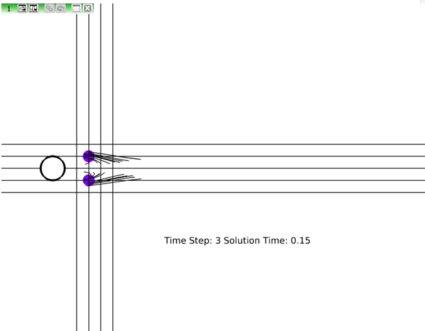

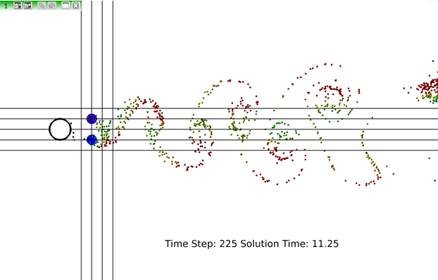

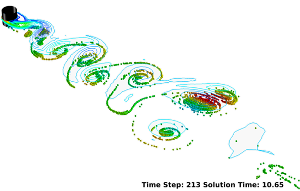

This tutorial shows you how to work with transient data. It also shows how to create streaklines to visualize transient flow patterns. An outline is presented for setting up rakes which can be used for subsequent work with other datasets.
