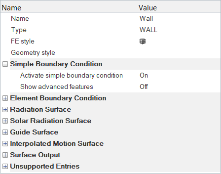

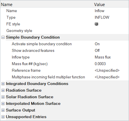

Specify the Boundary Conditions
By default, all components are assigned to the wall boundary condition. In this step, you will change them to the appropriate boundary conditions and assign material properties to the fluid volumes.

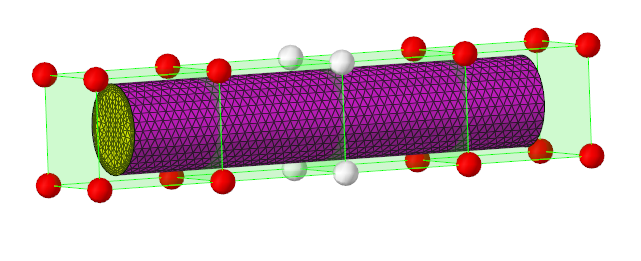

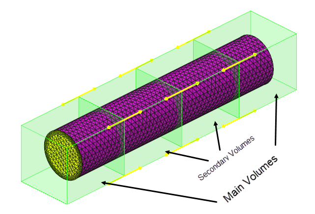

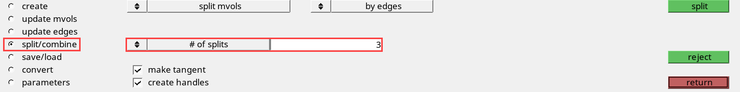

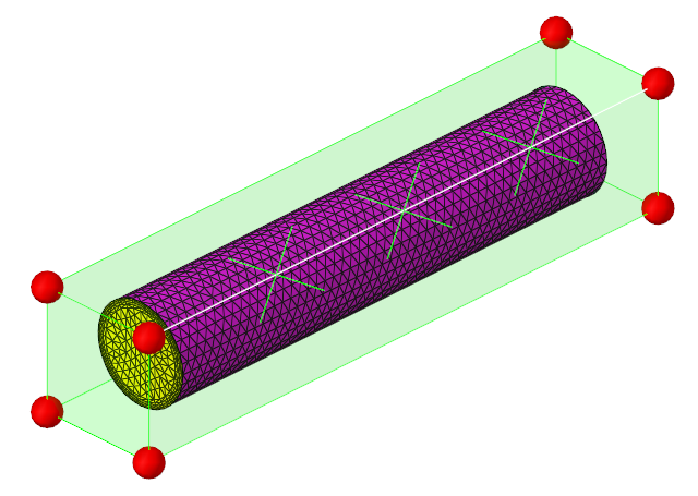

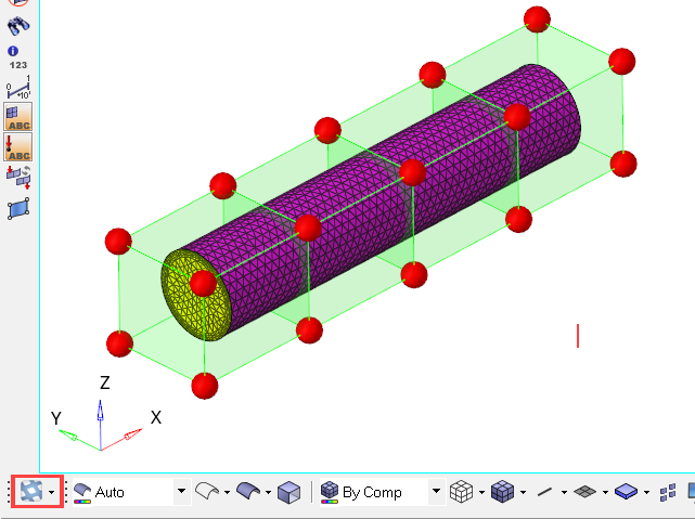

Generate and Export Morph Shapes
Define the Design Variable

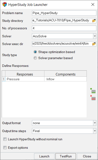

Launch the DOE Study Using HyperStudy
Start the Nominal Run
In the HyperStudy window, check step by step by clicking on each setup from the Explorer menu to ensure that everything was properly defined.

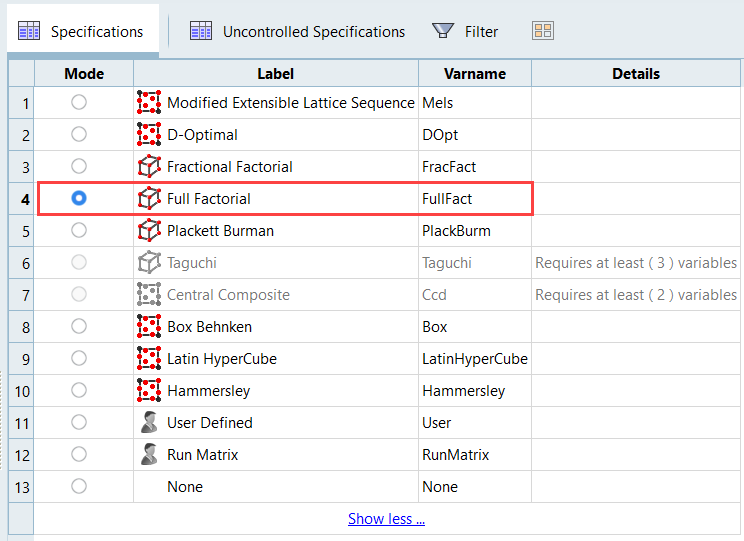

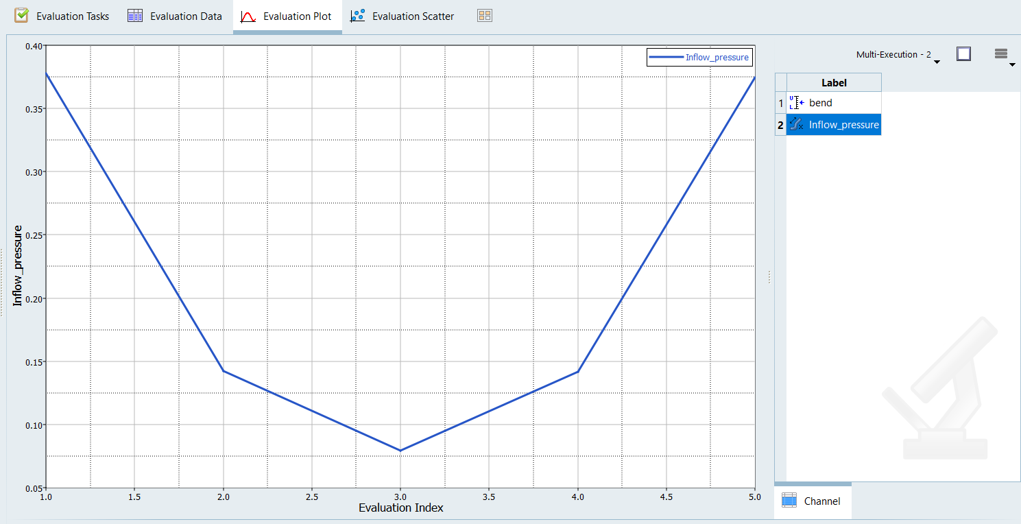

Run the DOE Study

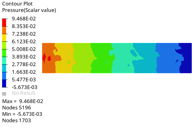

Post-Process the Results with HyperView
Switch to the HyperView Interface and Load the AcuSolve Model and Results

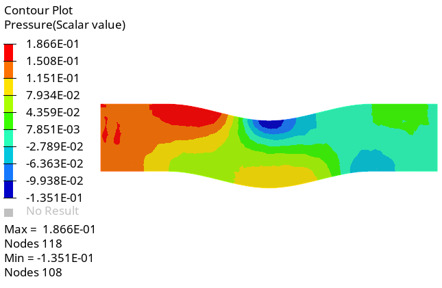

Create a Pressure Contour on a Cut Plane
Summary
This tutorial introduced you to running a DOE study using Altair products, namely HyperMesh, AcuSolve, HyperStudy and HyperView. You started by importing a HyperMesh database and then set up the simulation parameters for AcuSolve and created a morph shape using HyperMorph. Next, you set up the design variable and linked the morph shape to it. Then, you proceeded to set up the DOE study. Once the results were obtained, you processed the results using HyperView.
