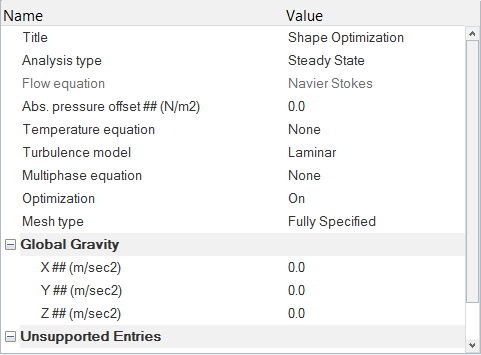

Set the Global Simulation Parameters
Set the Analysis Parameters

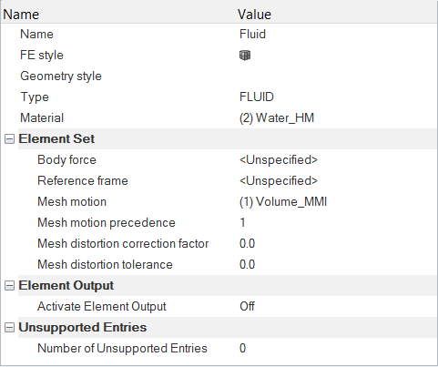

Create Mesh Motion and Set the Boundary Conditions and Material Model Parameters
Create Mesh Motion

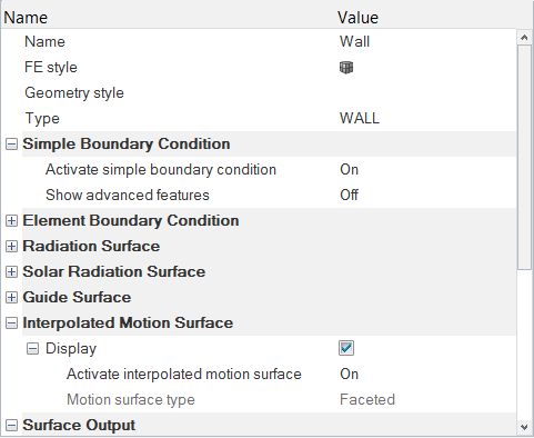

An optimization study can be performed in AcuSolve using either volume morph shapes or surface morph shapes. If volume morph shapes are used for simulation, you do not need to define mesh motion, as the volume nodes will move using the input from morph shapes. If surface morph shapes are used for simulation, interpolated mesh motion is needed to define the motion of volume nodes in the model. For this tutorial, surface morph shapes with interpolated mesh motion is used.

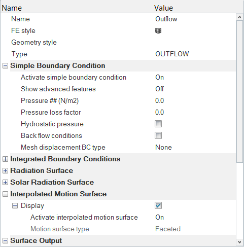

Specify the Boundary Conditions and Material Models Parameters

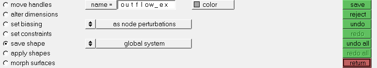

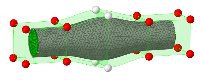

Generate and Export Morph Shapes

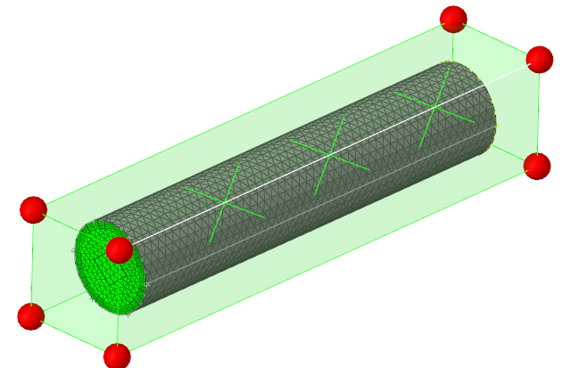

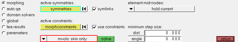

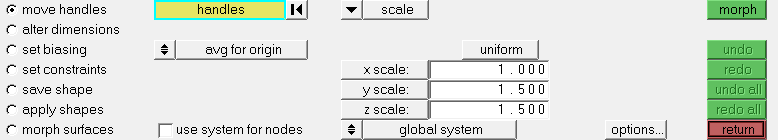

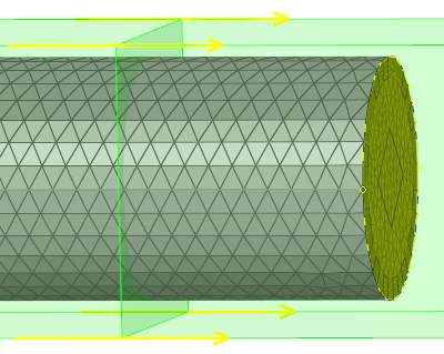

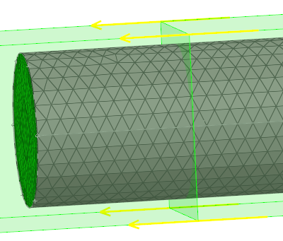

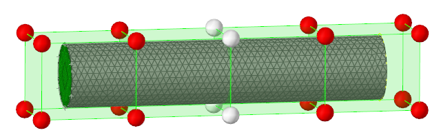

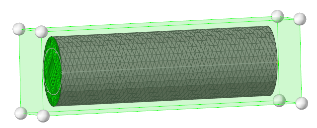

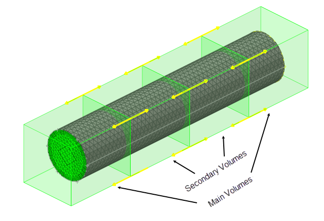

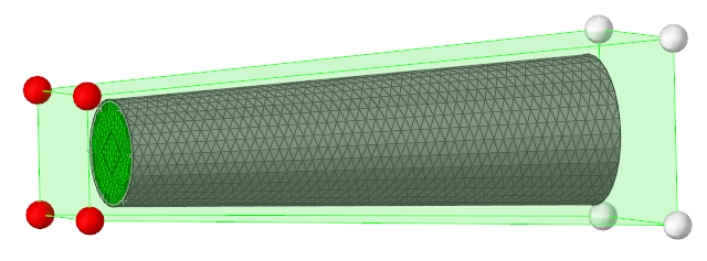

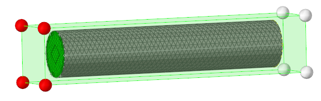

HyperMorph is used to parameterize the shape of the design. You will create morph shapes by moving the surface nodes. The volume nodes will be taken care of using the interpolated mesh motion feature of AcuSolve.

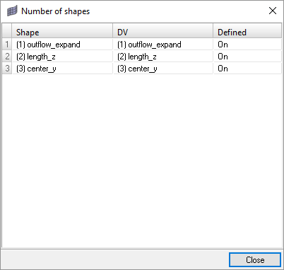

Define the Design Variable
- Right-click on 10.Optimization in the Solver Browser and select from the context menu.
- Rename the variable to outflow_expand and press Enter.
- In the Entity Editor, set the Initial Value to 0.7.
- Set the Lower Bound to 0.2.
- Set the Upper Bound to 1.5.
- Set the Max Update Factor to 0.02.
- Follow the above steps to create two new design variables, length_z and center_y. Use identical parameters as above to define these two new design variables.

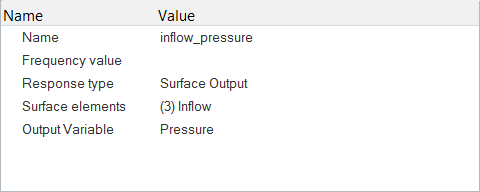

Define the Response Variable
Define the Objective
- Right-click on Optimization in the Solver Browser and select from the context menu.
- Rename the objective to maximize_inflow_pressure and press Enter
- In the Entity Editor, set the Objective Type is set to Maximize.
- Select inflow_pressure as the Response variable.

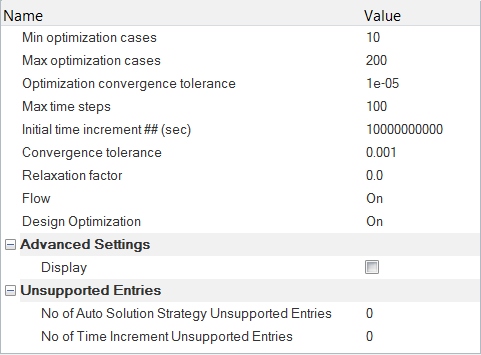

Set Up Optimization Controls
- In the Entity Editor, expand .
- In the Entity Editor, select maximize_inflow_pressure as the Objective.
- Verify that the Optimizer convergence tolerance is set to 1e-4.

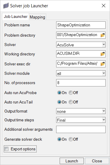

In this step, you will launch AcuSolve directly from HyperMesh and compute the solution.
Run AcuSolve

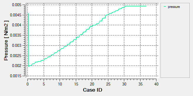

Monitor the Solution with AcuProbe
AcuProbe can be used to monitor various variables over solution time. An AcuProbe window will be launched by the Solver Job Launcher if the Auto run AcuProbe flag is set to On.

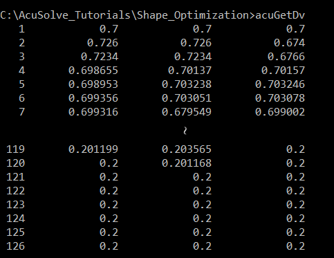

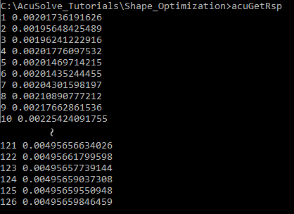

AcuGetDv and AcuGetRsp
AcuSolve provides two post-processing utilities specific to optimization problems, AcuGetDv and AcuGetRsp. AcuGetDv provides the values of the design variables for all the cases included in the solution. AcuGetRsp provides the values of the response variables for all the cases included in the solution.
