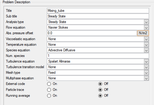

In next steps you will review parameters that apply globally to the simulation. To make this simple, the basic settings applicable for any simulation can be filtered using the BAS filter in the Data Tree Manager. This filter enables display of only a small subset of the available items in the Data Tree and makes navigation of the entries easier.
The general parameters that you will set for this tutorial are for turbulent flow, steady analysis, and mesh type as fixed.

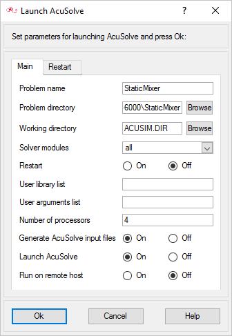

Run AcuSolve
In the next steps you will launch AcuSolve to compute the solution for this case.

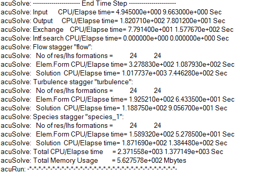

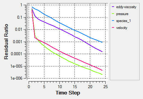

Monitor the Solution with AcuProbe
AcuProbe can be used to monitor residuals.

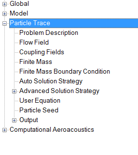

Define Particle Trace Parameters for Static Analysis
In the next steps you will define the particle trace data.

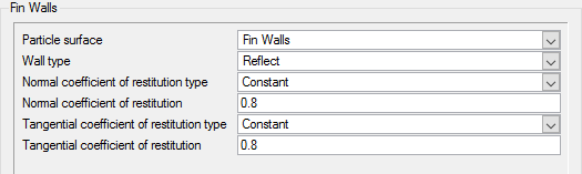

Define Finite Mass Boundary Conditions
In the next steps you will set the finite mass boundary conditions.
Define Particle Seeds
In the next steps you will define the particle seeds that are moving into the flow regime.
Define the Output Parameters
In the next steps you will define the output parameters.

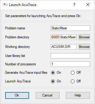

Run AcuTrace
In the next steps, you will launch AcuTrace to compute the solution for this case.

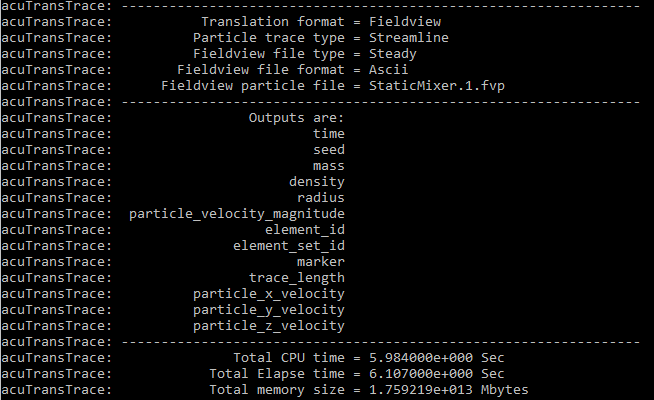

Convert Results for AcuFieldView
Once the run is complete, you need to convert the results so that they can be read in AcuFieldView. To do this, run the AcuTransTrace utility. This tool can be used to convert data for Ensight, FieldView or AcuDisplay.

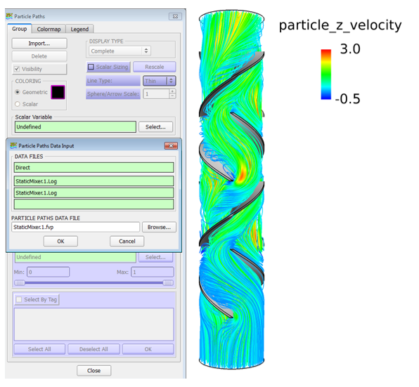

- How to find the data readers in the File pull-down on the Main menu and open up the desired reader panel for data input.
- How to find the visualization panels either from the Side toolbar or the Visualization panel pull-downs on the Main menu to create and modify surfaces in AcuFieldView.
- How to move the data around the modeling window using mouse actions to translate, rotate and zoom in to the data.
Figure 17.

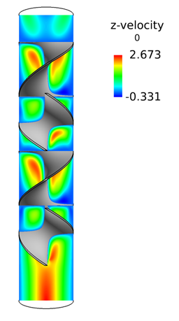

Set the Coordinate Surface Showing Velocity Magnitude on the Mid Coordinate Surface
