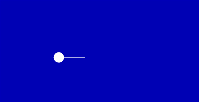

Figure 1. Schematic of the Problem

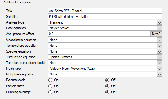

Set General Simulation Attributes
In the next steps you will modify global settings needed for the rigid body rotation of the piezoelectric harvester.

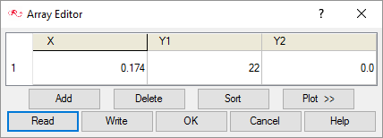

Create a Multiplier Function for Mesh Motion
The variation of the rotation angle () is modeled using a multiplier function using the following steps.

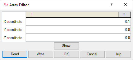

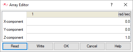

Create Mesh Motion for Rigid Body Rotation

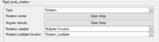

In the next steps you will define the rigid body rotation of the cylinder and the beam.

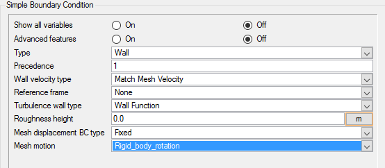

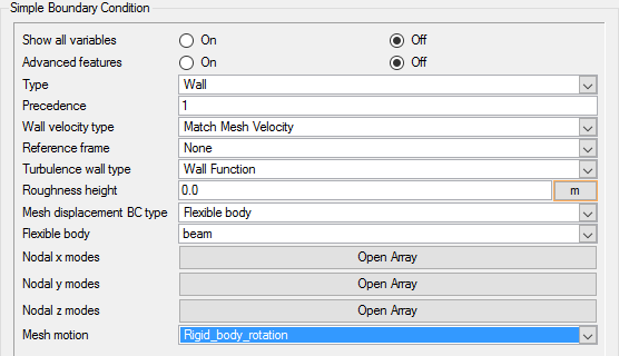

Assign Rigid Body Motion to the Beam Surface
Assign Rigid Body Motion to the Cylinder Surface

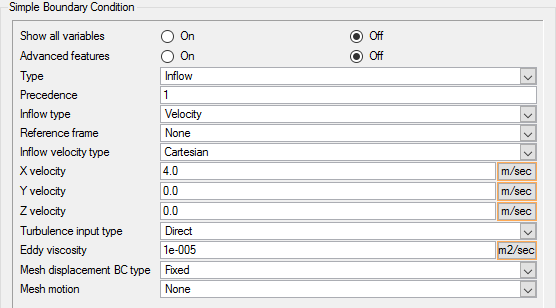

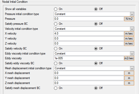

Reduce the Inlet Velocity
As mentioned in Analyze the Problem, you will set the inlet velocity to 4 m/sec.
Set Initial Conditions
In the next steps you will set the initial conditions.

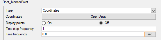

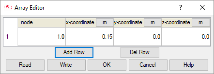

Add Time History Output Point
Time History Output commands enables you to extract the nodal solution at any point within the domain. In this simulation, it would be interesting to observe the displacement at the tip and root of the cantilever beam. The .acs database you started with has a monitor point at the tip of the cantilever beam.
The following steps will create a similar monitor point at the root of the cantilever beam.

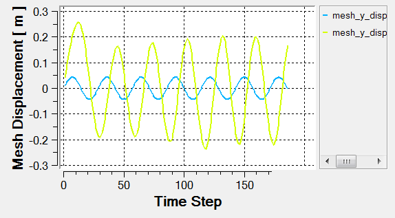

Post-Process with AcuProbe
AcuProbe can be used to monitor various variables over solution time.
