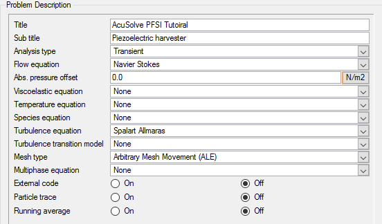

- Set general problem parameters

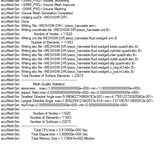

- Generate the mesh

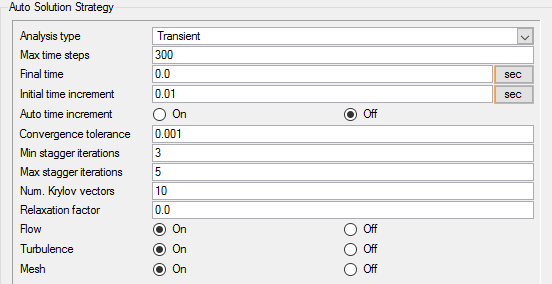

- Set solution strategy parameters

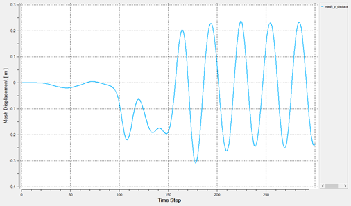

- Monitor the solution with AcuProbe

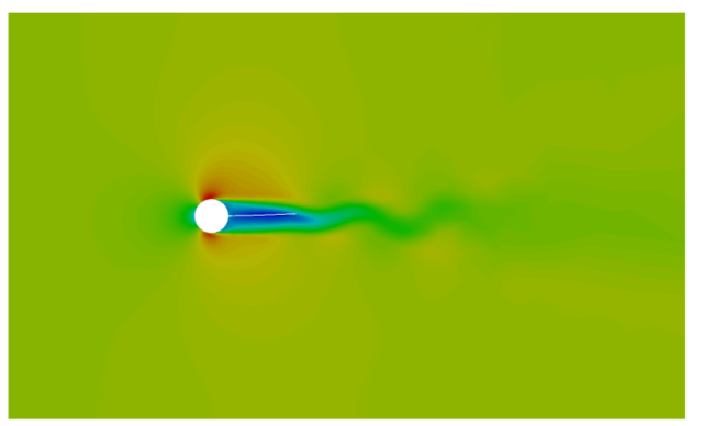

- Post-process the nodal output with AcuFieldView

Set General Simulation Parameters
In next steps you will set parameters that apply globally to the simulation. To make this simple, the basic settings applicable for any simulation can be filtered using the BAS filter in the Data Tree Manager. This filter enables display of only a small subset of the available items in the Data Tree and makes navigation of the entries easier.

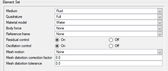

Volume groups are containers used for storing information about a volume region. This information includes solution and meshing parameters applied to the volume and the geometric regions that these settings are applied to.
When the geometry was imported into AcuConsole, all volumes were placed into the "default" volume container. Since the model for this tutorial has only a single volume, it will be the only volume in the default volume group when the geometry is imported. Even when there is a single volume in the model, it is advisable to rename the volume for ease of identification in the future.
In the next steps you will rename the default volume group container and set the material and other properties for it.

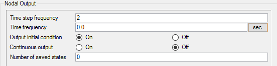

Define Nodal Outputs
The nodal output command specifies the nodal output parameters, for example, output frequency and number of saved states.

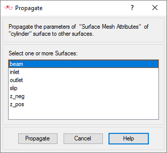

Set Surface Mesh Parameters
Surface mesh attributes are applied to a specific surface in the model. It is a type of local meshing parameter used to create targeted mesh controls for one or more specific surfaces.
Setting local mesh attributes, such as surface mesh attributes, is not mandatory. When a local mesh attribute is not found for a component, the global attributes are used as the mesh generation control for that component. If a local mesh attribute is present, it will take precedence over the global setting.
In the next steps you will set the surface meshing attributes.

Generate the Mesh
In the next steps you will generate the mesh that will be used when computing a solution for the problem.

Post-Process with AcuProbe
AcuProbe can be used to monitor various variables over solution time.

Visualize and Save an Animation of the Beam Displacement
