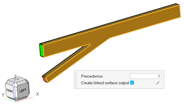

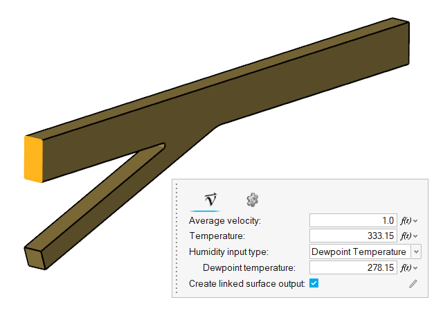

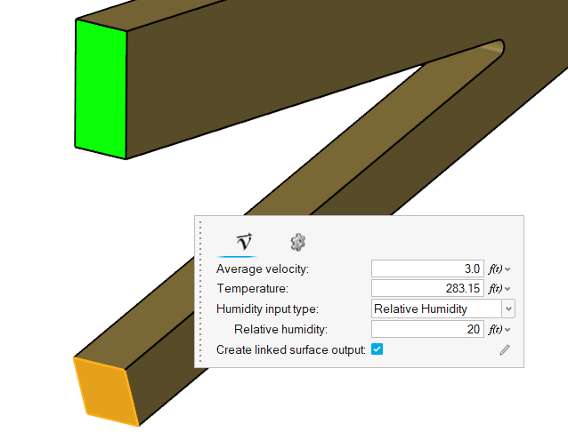

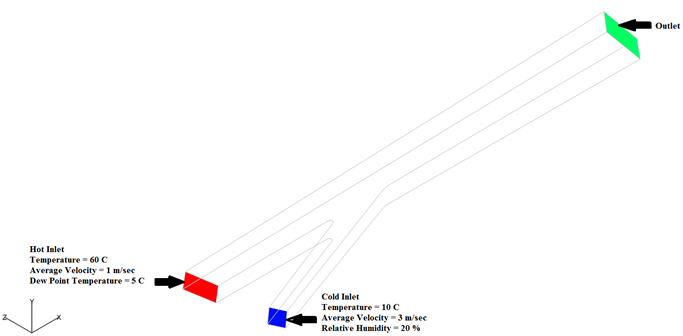

The problem to be addressed in this tutorial is shown schematically in Figure 1. As an example, a pipe junction problem is attached here to show the capability of the Humidity modelling in AcuSolve. In this problem, there are two inlets with different flow, thermal, and humidity conditions. As the flow proceeds downstream of the pipe, two pipes merge into a single pipe to create a single outlet and a distinct profile of temperature and humidity is attained. The geometry is symmetric about the XZ midplane of the pipe, as shown in the figure.

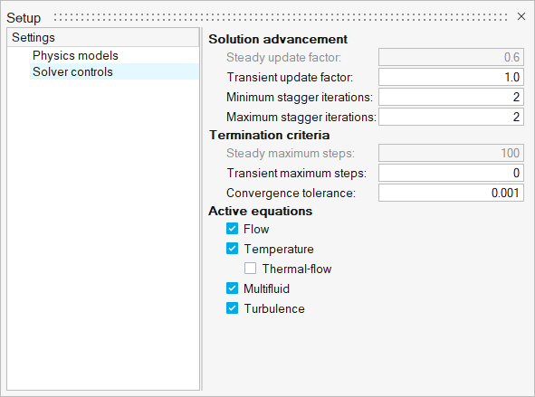

Set Up Flow

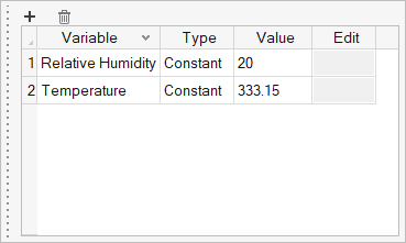

Define the Nodal Initial Conditions

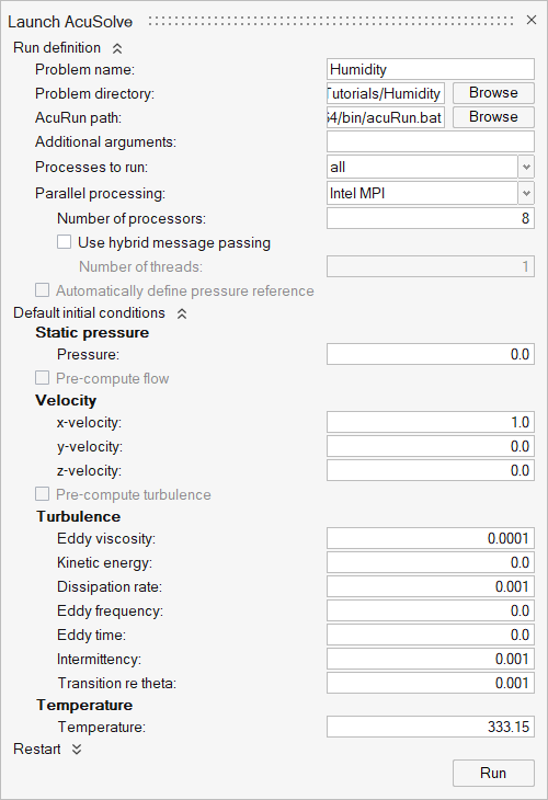

Run AcuSolve

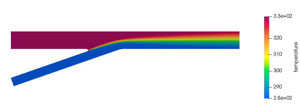

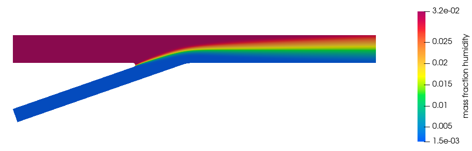

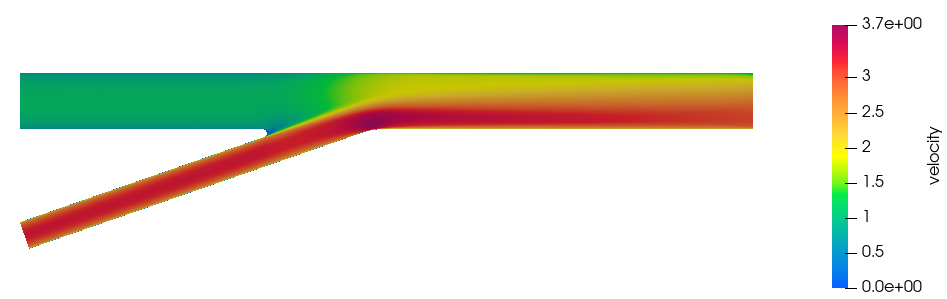

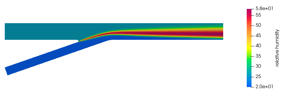

In this step, you will create contour plots for temperature, relative humidity, mass fraction humidity, and velocity.

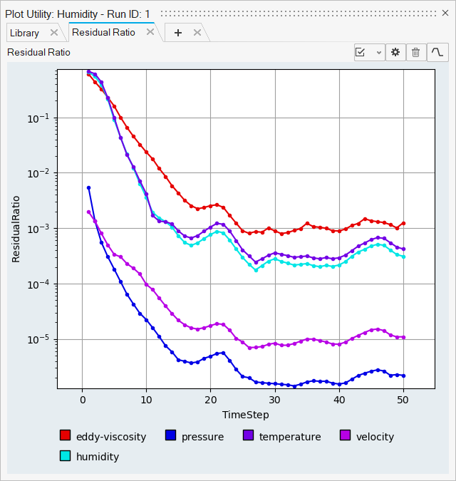

In this tutorial, you learned how to set up and solve a humidity transport simulation using HyperWorks CFD and AcuSolve. You started by importing the HyperWorks CFD input database and then defined the flow setup. Once the solution was computed, you created a plot of residual ratios using the plot utility in HyperWorks CFD. Finally, you created a contour plot of temperature distribution, relative humidity, humidity mass fraction, and velocity using HyperWorks CFD Post.
