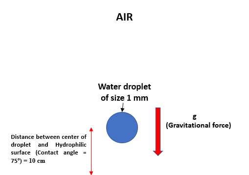

Problem Description

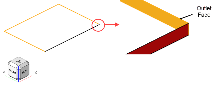

Validate the Geometry
Figure 3.

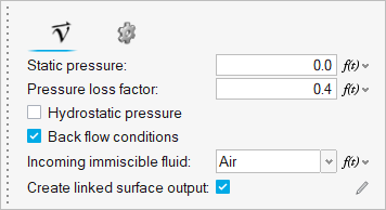

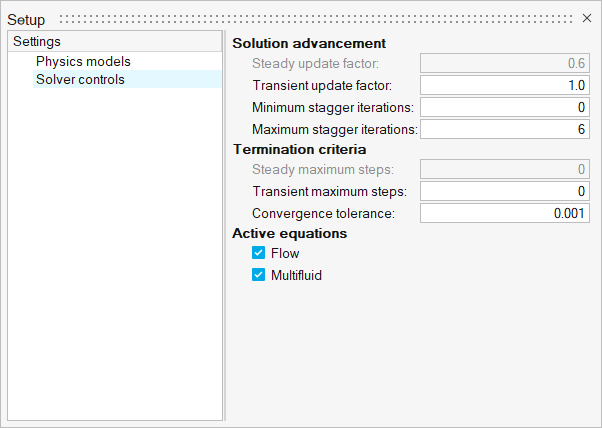

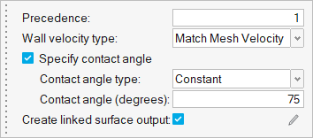

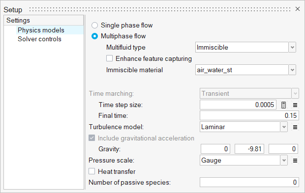

Set Up Flow

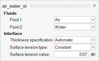

Create Materials

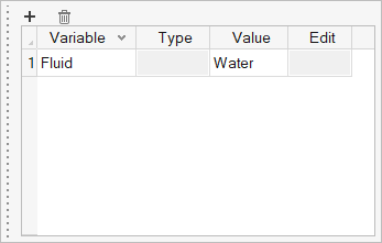

Assign Material Properties

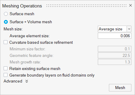

Generate the Mesh

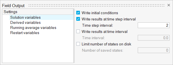

In this step, you will define the nodal output frequency and then specify the nodal initial conditions for the water droplet.
Define Nodal Output Frequency

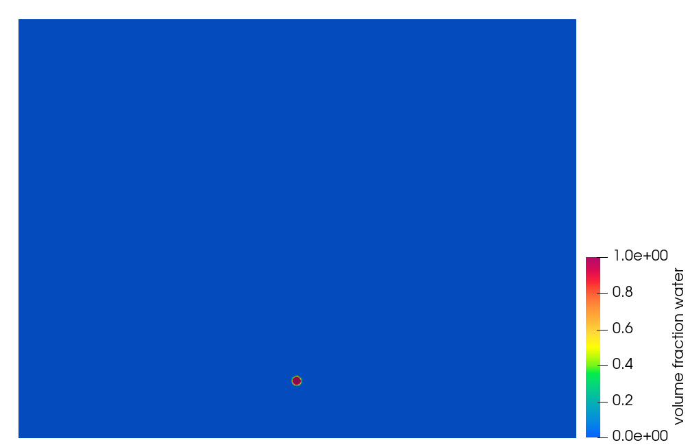

Define Nodal Initial Conditions

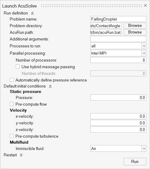

Run AcuSolve

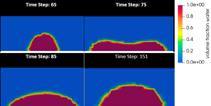

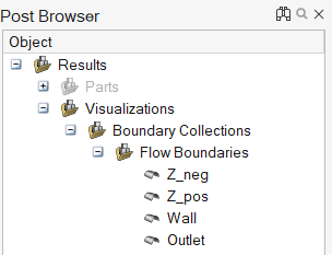

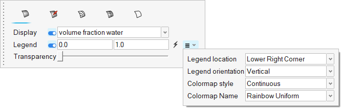

Post-Process the Results with HW-CFD Post
Summary
In this tutorial, you successfully learned how to set up and solve a simulation involving contact angle and surface tension using HyperWorks CFD. You imported the geometry and then defined the simulation parameters and flow boundary conditions. Once the solution was computed, you used HW-CFD post to create the contours of volume fraction of water
