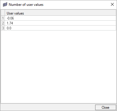

- Α = Amplitude of oscillation = -0.06 m
- ω = Frequency of oscillation = = 3.6 rad/sec
- T = Time period of oscillation = 1.74 sec
- φ = Phase difference = 0

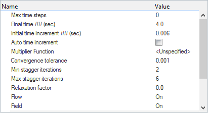

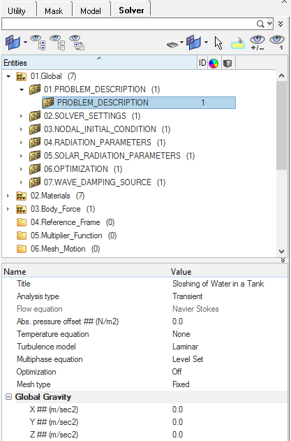

Set the Analysis Parameters

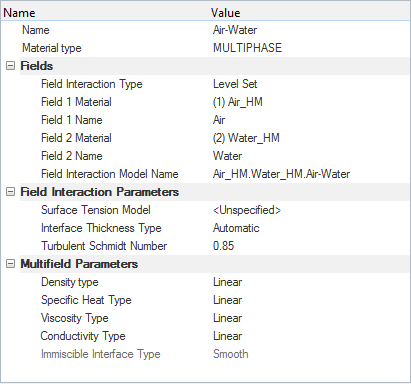

Create a Multiphase Model and Set the Body Force
Create a Multiphase Material Model

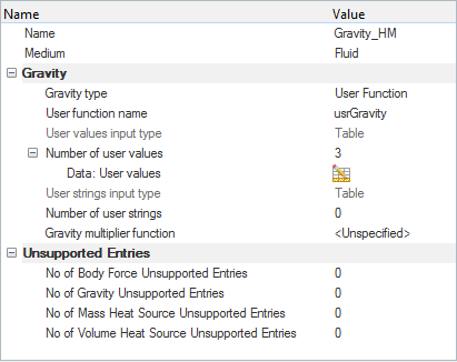

Set the Body Force

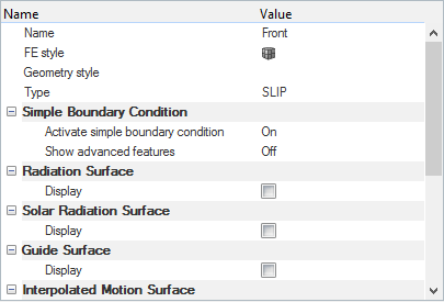

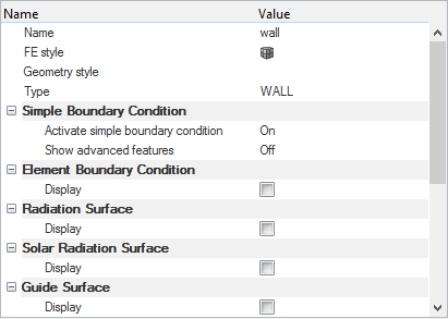

Set the Boundary Conditions and Nodal Initial Conditions

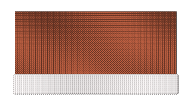

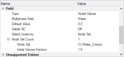

Set the Nodal Initial Conditions
Assign Nodes to the Node Set

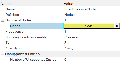

Assign the Reference Pressure

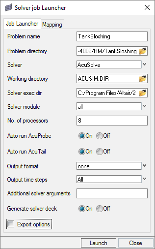

In this step, you will launch AcuSolve directly from HyperMesh and compute the solution.
Run AcuSolve
