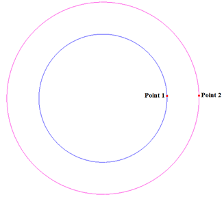

Figure 1 shows a simple 2D cable problem wherein the inner cylinder is provided with a volumetric heat source of 1.46686 W and is in contact with the outer cylinder, the outer surface of which is maintained at a temperature of 20oC (293K).This problem forms the basis of a simple conduction analysis between two concentric cylinders. The only difference from the basic problem is that the heat source is calculated using another software called Flux and is provided using AcuConsole’s EMag (Electromagnetic) Manger to account for volumetric losses from Flux to AcuSolve.

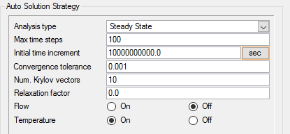

Set Solution Strategy Parameters
In the next steps you will set parameters that control the behavior of AcuSolve as it progresses during the solution.

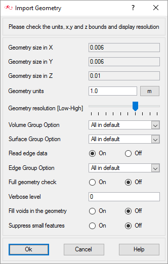

Import the Geometry and Define the Model
Import the Geometry

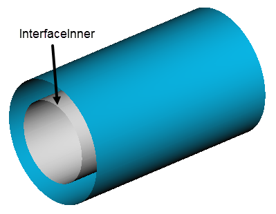

Create Surface Groups and Apply Surface Parameters
Surface groups are containers used for storing information about a surface, including solution and meshing parameters, and the corresponding surface in the geometry that the parameters will apply to.
In the next steps you will define surface groups, assign the appropriate settings for the different characteristics of the problem, and add surfaces to the group containers.

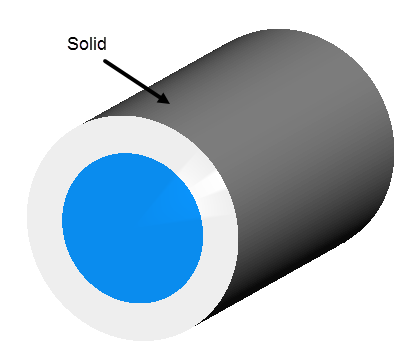

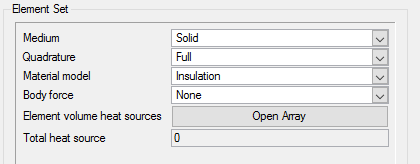

Assign Volume Parameters (Element Material Properties)
Solid
SolidHeated

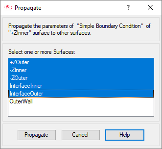

The SolidHeated group will have the same settings as Solid group. In order to not to repeat the step again, we can propagate the settings to that group as follows:

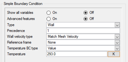

Assign Surface Parameters (Boundary Conditions)
In next steps, you will set boundary conditions for the surfaces that apply globally to the simulation. To make this simple, the boundary conditions applicable for any simulation can be filtered using the BC filter in the Data Tree Manager.

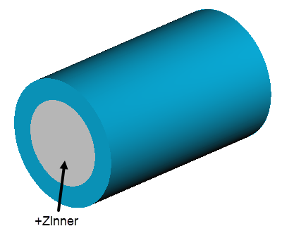

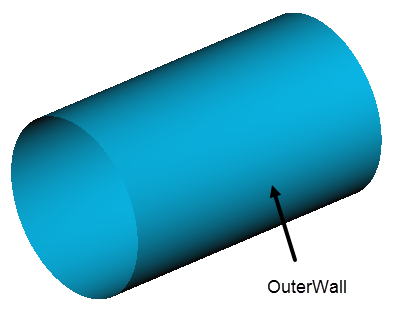

OuterWall
The OuterWall group defines the wall through which conduction takes place.

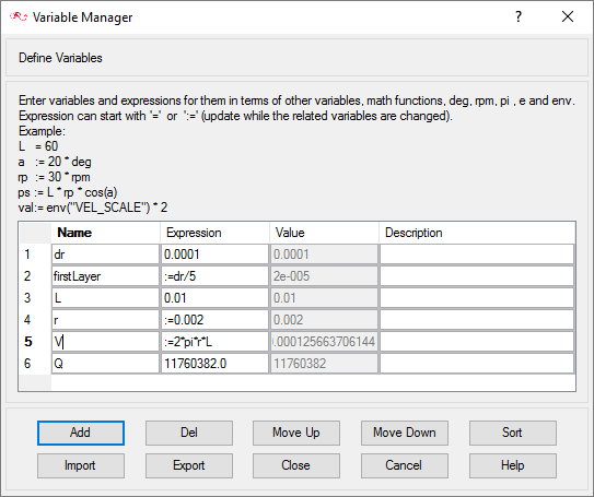

Define the Variables List

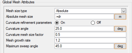

Set Global Mesh Attributes
Now that the flow characteristics have been set for the whole problem, a sufficiently refined mesh has to be generated.
Global mesh attributes are the meshing parameters applied to the model as a whole without reference to a specific geometric volume, surface, edge, or point. Local mesh attributes are used to create mesh generation controls for specific geometry components of the model.
In the next steps you will set the global mesh attributes.

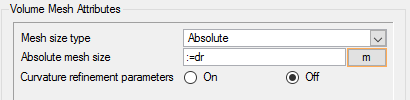

Set Volume Mesh Attributes
Volume mesh attributes are the meshing parameters applied to a particular volume. You have the option to control the mesh size on a volume and define curvature refinement parameters like curvature angle and the curvature mesh size factor.
In the next steps you will set the volume mesh attributes.

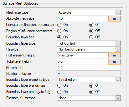

Set Surface Mesh Attributes
Surface mesh attributes are applied to a specific surface in the model. It is a type of local meshing parameter used to create targeted mesh controls for one or more specific surfaces.
Setting local mesh attributes, such as surface mesh attributes, is not mandatory. When a local mesh attribute is not found for a component, the global attributes are used as the mesh generation control for that component. If a local mesh attribute is present, it will take precedence over the global setting.
In the next steps you will set the surface meshing attributes.

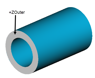

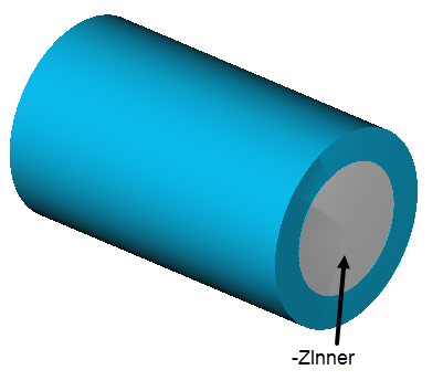

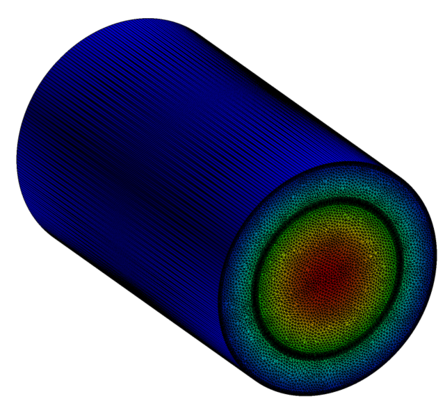

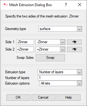

Define Mesh Extrusions
Mesh extrusion is a feature that allows the generation of structured mesh in the entire volume or only on the surface. This feature extrudes the mesh on one surface to another surface and can also be used with other meshing features. In this case, we are going to extrude the mesh along the length of both the Inner and Outer cylinders from one end to the other.
Mesh Extrusion is available under the Model tree.

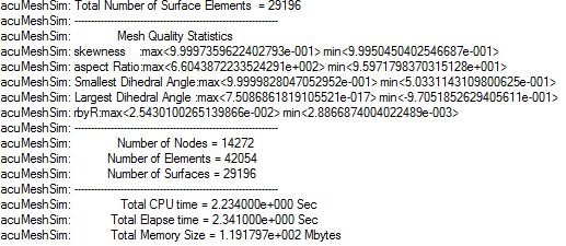

Generate the Mesh
In the next steps you will generate the mesh that will be used when computing a solution for the problem.

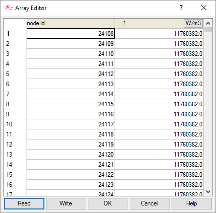

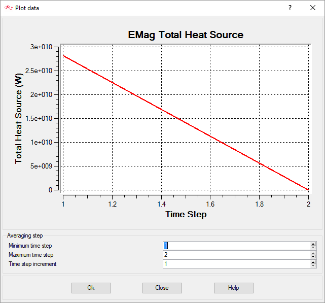

Transfer Heat Loss Using the Electromagnetics Manager
The Electromagnetics Manager is a tool designed for transferring the electromechanical heat losses from an EMag (Electromagnetics) output file to the appropriate element set in the CFD mesh. Flux is a simulation software used in the development and design of electrical devices. It incorporates simulation technology to accurately analyze a wide range of physical phenomena that includes complicated geometry, various material properties, and the heat and structure at the center of electromagnetic fields. The electromagnetics mesh and the element set of the CFD mesh on to which the data is transferred must have the same size and coordinates.
In this case, the heat load is already calculated from the Electromagnetics software and imported into the CFD mesh in the form of a .nas (NASTRAN) file. You do not need to calculate this value; it is provided directly with the input files. In the next steps, you will learn how to import this .nas file using the Electromagnetics Manager.

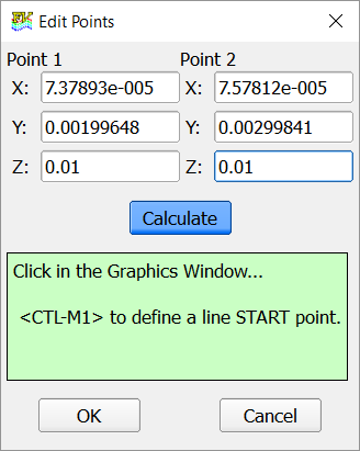

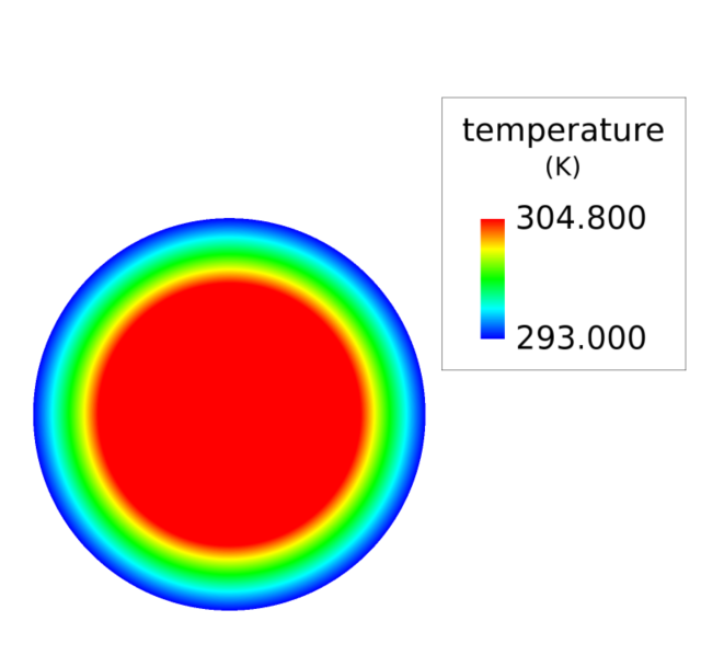

Create a Boundary Surface Showing Temperature on the Surface

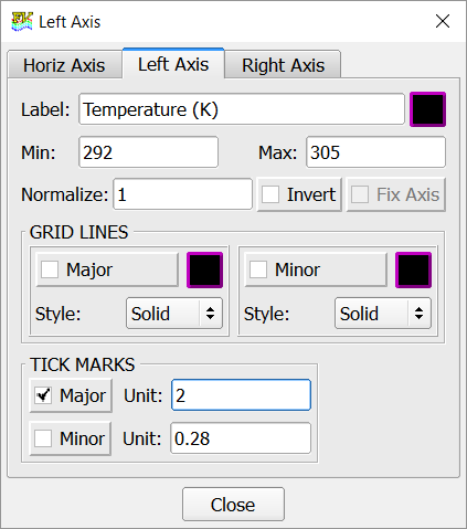

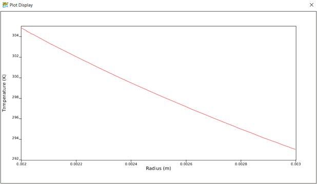

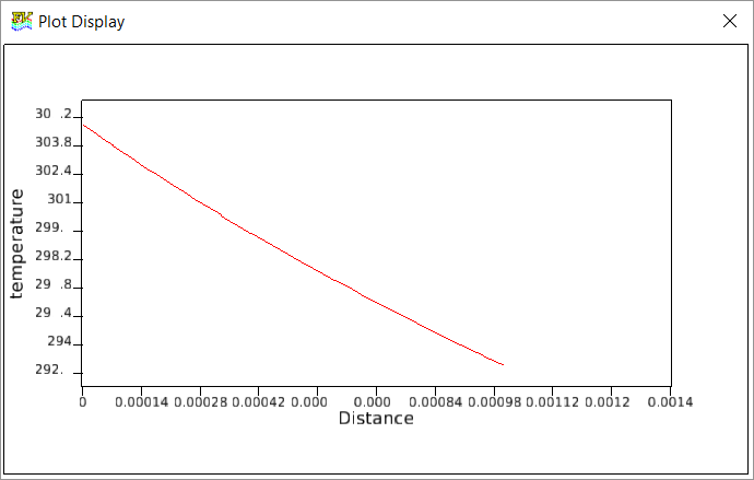

Create an XY Plot for Temperature vs Radius
Figure 37.
