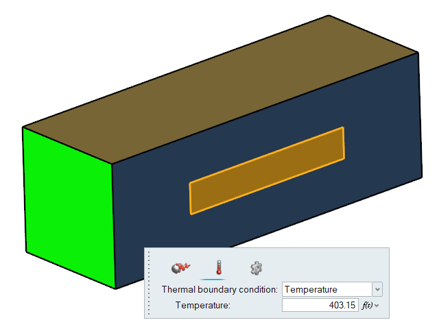

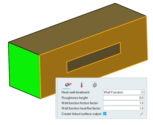

Set Up Flow

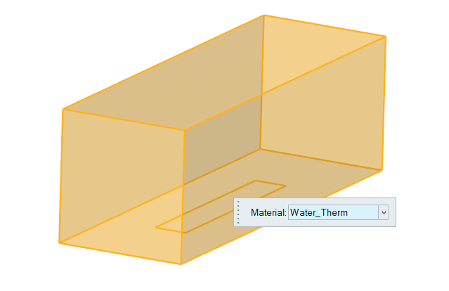

Assign Material Properties

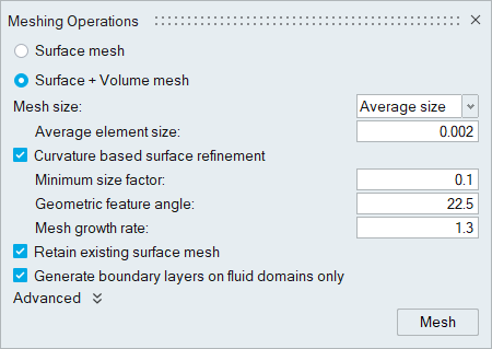

Generate the Mesh

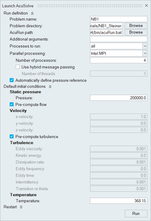

Run AcuSolve

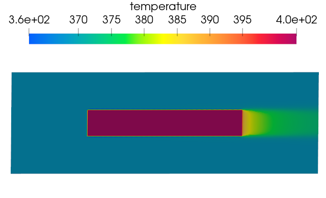

Post-Process the Results with HW-CFD Post
Summary
