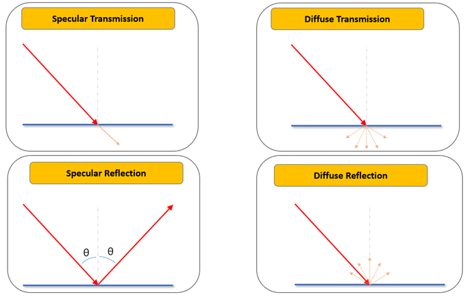

Solar Radiation Parameters
- Specular transmissivity
- Diffuse transmissivity
- Specular reflectivity
- Diffuse reflectivity
- Absorptivity
- Angle of incidence

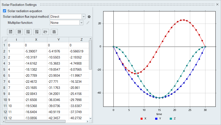

For the solar radiative heat fluxes to be computed, a solar radiation surface needs to be defined on that given surface.
In this tutorial, the solar flux loading is given in the form of a data file which was generated using the acuSflux script available in AcuSolve. The script can be used to generate a data file with a four-column array of solar flux vector data values. The piecewise linear type is used in this tutorial to emulate the pattern of sunrise to sunset over the atrium.
For example, to generate the solar load data file for a location with known geological coordinates, enter the following command in the AcuSolve Command Prompt: acuSflux -time "dec-3-2019 11:00:00" -tinc 1800 -nts 25 -lat 42.6064 -lon -83.1498 -ndir "1,0,0" -udir "0,0,1"

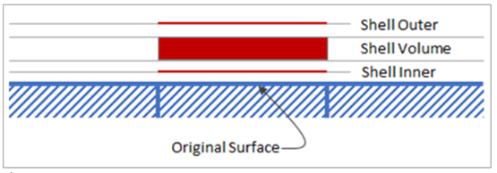

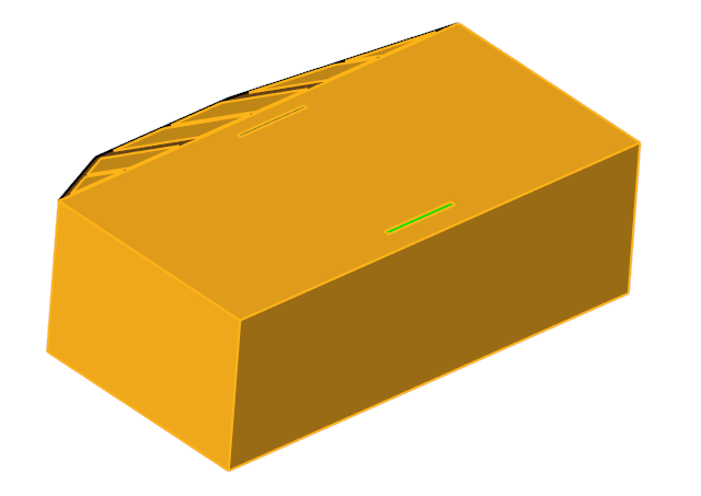

Thermal Shell Modeling
Figure 3.

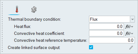

When defining a thermal shell on a surface, two sets of boundary conditions are needed. One for the Primary Wall surface i.e. Shell Inner and one for the Shell Outer Wall surface. In this tutorial, a solar radiation surface will be defined on the outer shell surface so that it receives solar heat flux, whereas the inner shell surface will be modeled as a default wall.

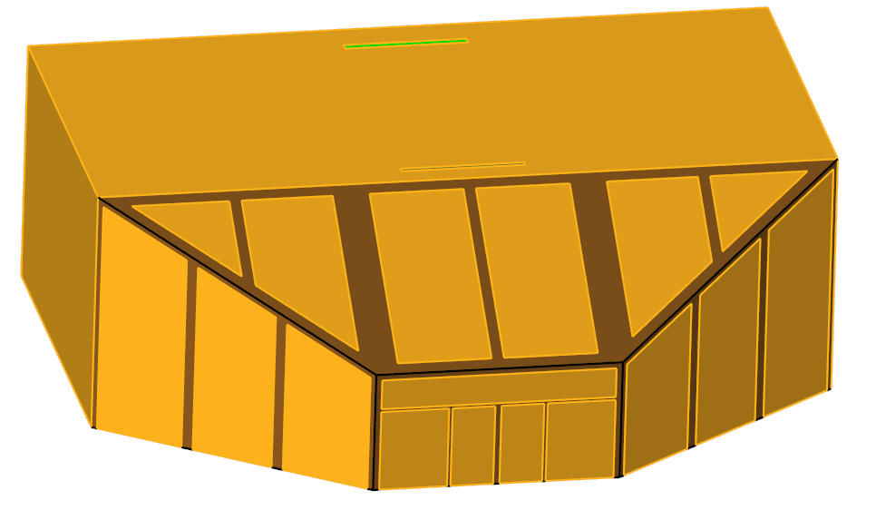

Start HyperWorks CFD and Create the HyperMesh Model Database
Import and Validate the Geometry
Import the Geometry

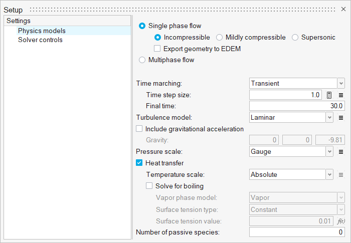

Set Up Flow

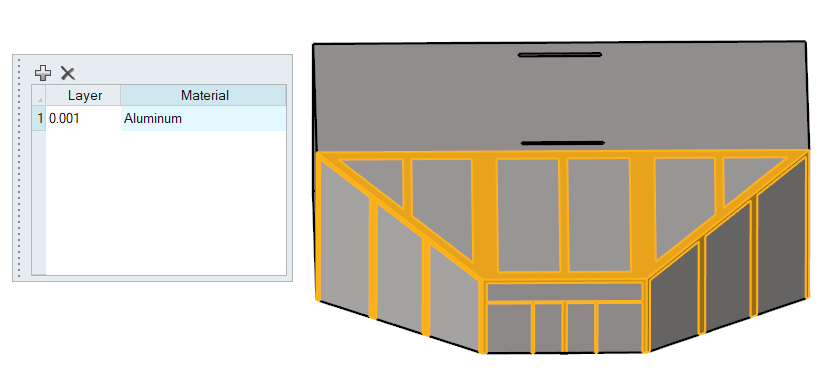

Define Thin Solids

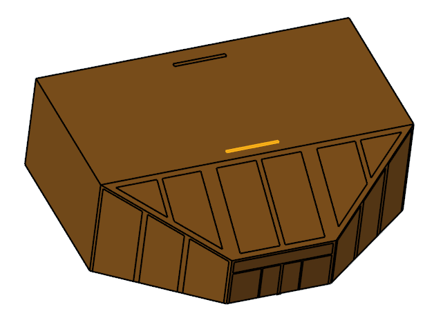

In this simulation, you will model the aluminum frames as a thin solid.

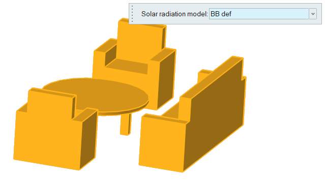

Set Up Solar Radiation

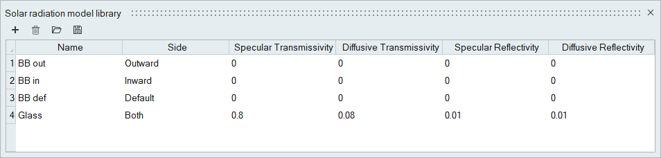

Set Up the Solar Radiation Parameters
Define the Solar Radiation Models

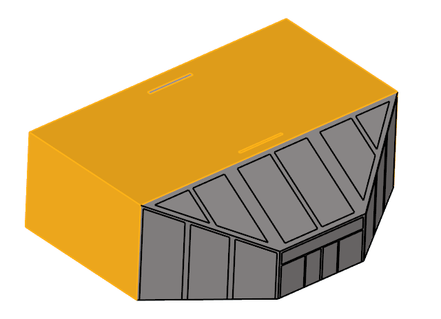

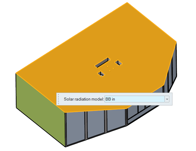

Assign the Solar Radiation Models

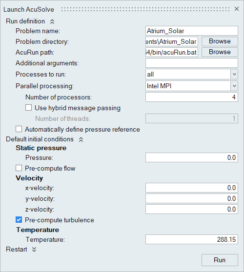

Define the Nodal Initial Conditions and Compute the Solution

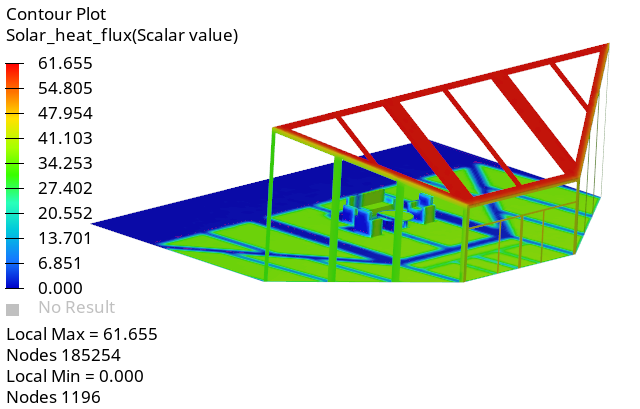

Post-Process the Results with HyperView
In this step, you will create an animation of solar heat flux and temperature over run time.

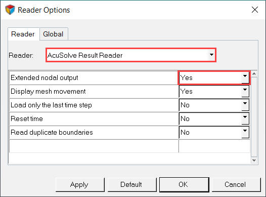

Open HyperView and Load the Model and Results

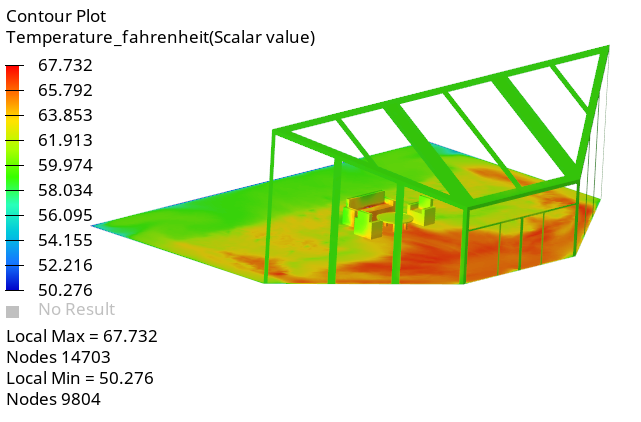

Create an Animation of Temperature Contour

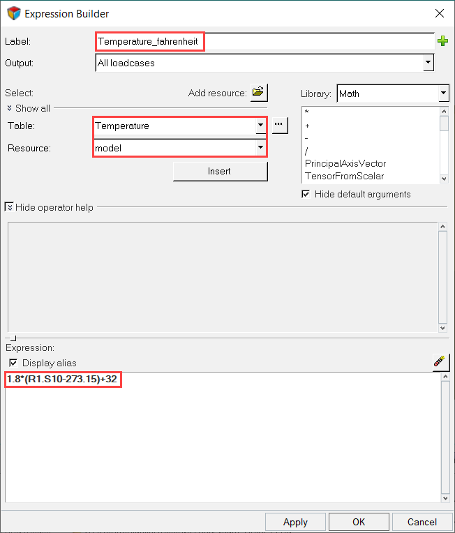

In this step, you will start by creating an expression for plotting the temperature values in Fahrenheit units. Then, you will create an animation of the magnitude of temperature on the floor and the thin solid wall surfaces.
Create an Animation of Solar Heat Flux
