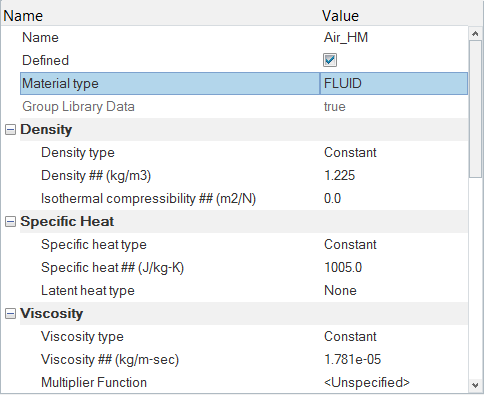

Set Up Fluid Volume Material

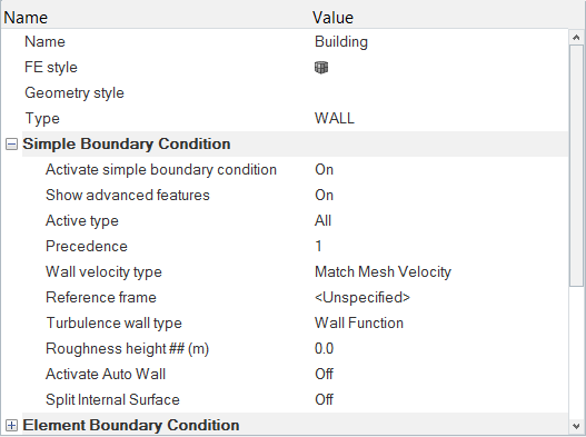

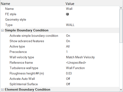

Set Up Boundary Conditions

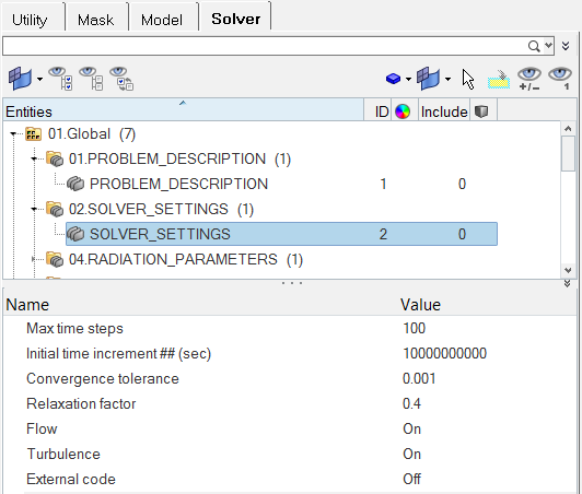

In this step, you will launch AcuSolve directly from HyperMesh and compute the solution.
Run AcuSolve

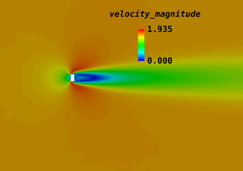

Coordinate the Surface for Showing Velocity Magnitude on the Y Plane

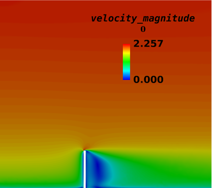

Coordinate the Surface for Showing Velocity Magnitude on the Z Plane
