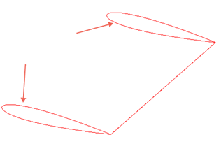

The problem to be addressed in this tutorial is shown schematically in the figure below. It consists of a cylindrical bounding region containing air that flows past a NACA0012 airfoil profile. The simulation is performed as 2D by including only a single layer of extruded elements in the airfoil span direction. The velocity vector at the far field boundary of the domain is specified to yield an angle of attack of 5 degrees and a Reynolds Number of 1.0e6. The airfoil chord is 1 meter, and standard air material properties are used for the simulation.
The diameter of the cylindrical bounding volume for the airfoil is set to 500 times the airfoil chord. This large bounding volume is selected to ensure that the farfield boundaries are sufficiently far from the airfoil to prevent any influence of blockage of the domain on the solution.

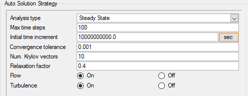

Set Solution Strategy Parameters
In the next steps you will set the parameters that control the behavior of AcuSolve as it progresses during the transient solution.

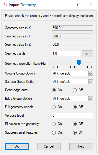

Import Airfoil Geometry

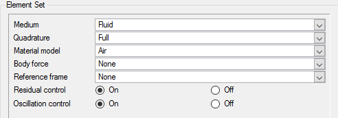

Create a Volume Group and Apply Volume Parameters
Volume groups are containers used for storing information about volumes. This information includes the list of geometric volumes associated with the container, as well as parameters such as material models and mesh sizing information.
When the geometry was imported into AcuConsole, all volumes were placed into the default volume container.
In the next steps you will rename the default group to Fluid, set the material for that group and add the volume from the geometry to that volume group.

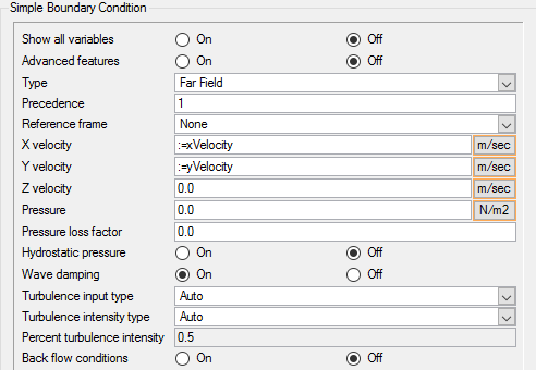

Set Farfield Boundary Conditions
In the next steps you will define a surface group for the farfield boundary, set the inlet velocity and add the corresponding surface from the geometry to this group.

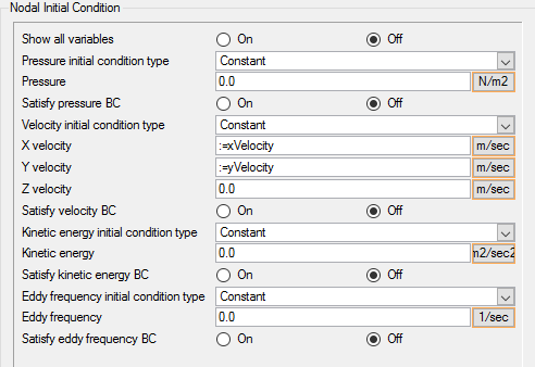

Define Nodal Initial Conditions
In the next steps you will define the nodal initial conditions.

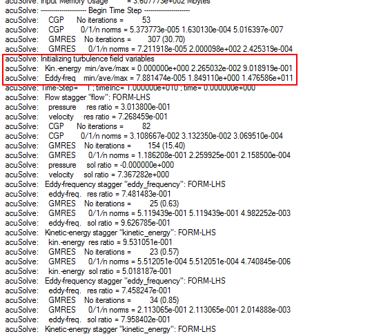

For the SST and K-Omega turbulence models, you need to enter the initial values for Kinetic energy and Eddy frequency. If you have a reasonable estimate of these values, you can enter them directly in the fields. One option is to use the same values that are assigned at the inlet boundary. In the absence of good estimates for the initial conditions, it is also possible to let AcuSolve perform an automatic initialization of the turbulence variables. By leaving these values set to zero, AcuSolve will trigger an automatic initialization of these variables.

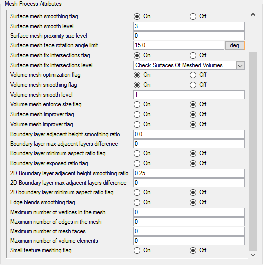

Set Mesh Process Parameters
- Locally reduce the number of layers in the boundary layer stack to maintain high quality boundary layer elements.
- Locally reduce the height of the boundary layer stack, but keep the total number of layers constant. Using this approach, the height of each layer is scaled by a constant factor to reduce the total height of the stack and avoid the creation of the poor quality boundary layer elements.

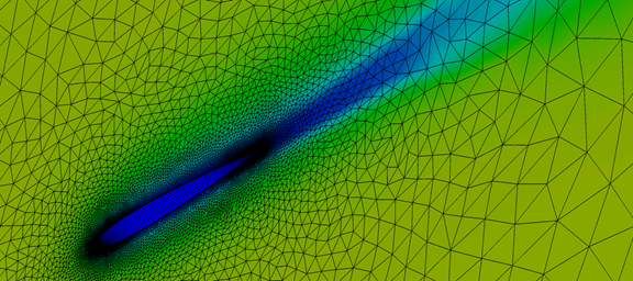

The surface mesh size on the airfoil is controlled through a combination of the mesh size set on the perimeter edges of the airfoil and the mesh size applied directly to the surface. In this tutorial you will also use the region of influence option of the surface mesh to create a refined mesh at a specified distance from the airfoil surface.

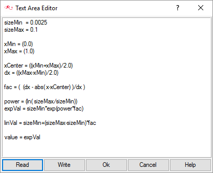

Set Edge Mesh Parameters
To create an optimum mesh on the surface of the airfoil, it is necessary to have high levels of refinement near the leading and trailing edges and a large element size near the mid chord. Since the surface mesh size was set to constant to serve as the size that is propagated into the volume for the region of influence refinement, you will use an edge mesh parameter to control the placement of nodes along the airfoil surface. To accomplish this, you will first need to create an edge group that contains the perimeter edges of the airfoil.

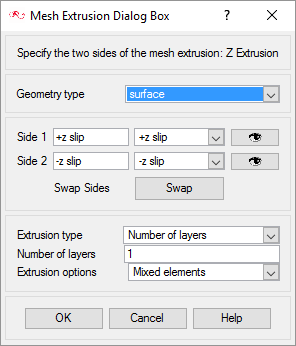

Set Mesh Extrusion Parameters
The final step in the setup of the meshing for the airfoil is the creation of a mesh extrusion attribute. This extrusion will be defined such that a single element is created across the span of the airfoil.

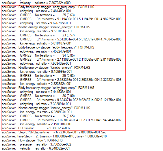

Run AcuSolve and Examine the .log File
In the next steps, you will launch AcuSolve to compute the solution for this case.

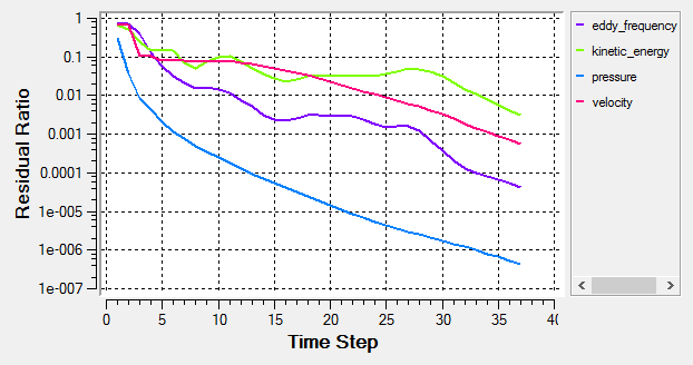

Monitor the Solution with AcuProbe
While AcuSolve is running, you can monitor the kinetic energy using AcuProbe.

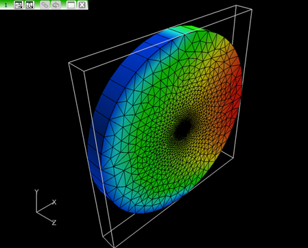

In the next steps you will create a boundary surface to display contours of a new variable, called the square root of the eddy period. When solving for the SST and k-omega turbulence models, AcuSolve introduces three new variables to the output; kinetic_energy (k), eddy_frequency (ω) and sqrt_eddy_per ( ). The sqrt_eddy_per variable is useful for visualizing the turbulent time scale since the eddy_frequency variable has such a large range of values, it is often times easier to visualize sqrt_eddy_per.
These steps are provided with the assumption that you are able to manipulate the view in AcuFieldView. If you are unfamiliar with basic AcuFieldView operations, refer to Manipulate the Model View in AcuFieldView.

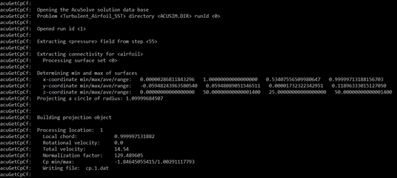

Run AcuGetCpCf

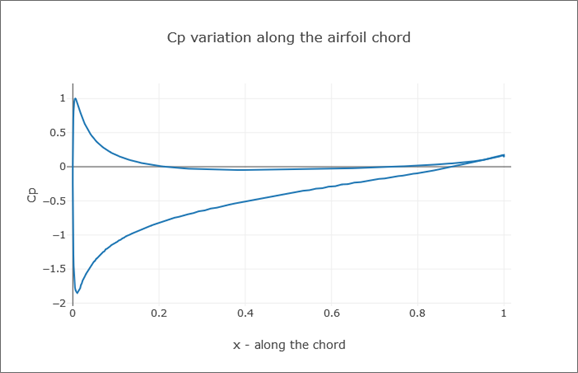

AcuGetCpCf is another utility script used to calculate the pressure coefficient (Cp) for the airfoil.
To execute the AcuGetCpCf script for this problem, follow the steps below:
