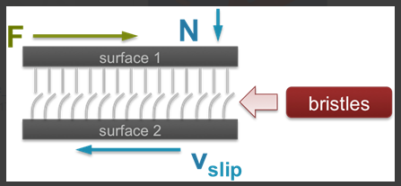

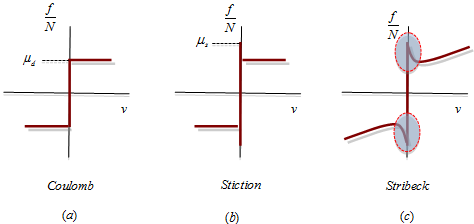

LuGre Friction Model
- = Stiction to dynamic friction transition velocity
- = Coefficient of static friction
- = Coefficient of dynamic friction
- = Bristle stiffness
- = Bristle damping
- = Viscous coefficient
- Velocity in joint v =
- Stribeck factor
- The normal force
- Coulomb friction
- Static Friction

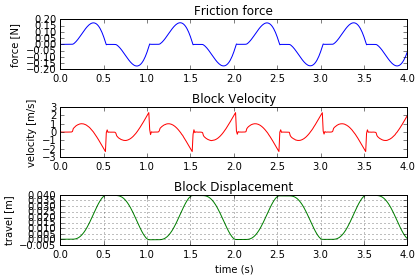

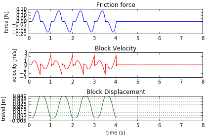

You can study the effect of changing the Static Friction Coefficient μs on the computed friction force by modifying it between simulations.
The model is created inside a function, called _slidingblock, in the code cell below. This is done purely for convenience.
