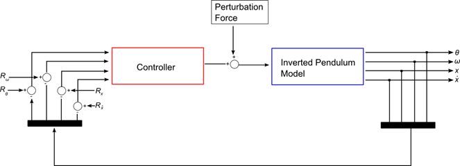

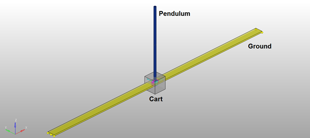

Consider an inverted pendulum, mounted on a cart. The pendulum is constrained at its base to the cart by a revolute joint. The cart is free to translate along the X direction only. The pendulum is given an initial rotational velocity causing it to rotate about the base.
Figure 1. Inverted Pendulum Model Setup
Figure 2. Block Diagram Representation of the Controller
- is the angular displacement of the pendulum from its model configuration
- is the angular velocity of the pendulum about its center of gravity as measured in the ground frame of reference
- is the translational displacement of the cart measured from its model configuration in the ground frame of reference
- is the translational velocity of the cart measured in the ground frame of reference
- is a reference signal for the pendulum's angular displacement
- is a reference signal for the pendulum's angular velocity
- is a reference signal for the cart's translational displacement
- is a reference signal for the cart's translational velocity
A disturbance is added to the computed control force to assess the system response. The controller force acts on the cart body to control the displacement and velocity profiles of the cart mass.

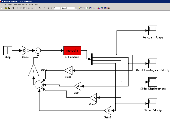

- Review the controller in Simulink.

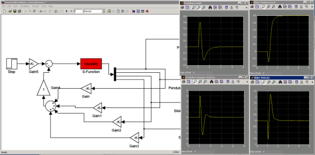

- Perform a co-simulation and compare the results between the standalone MotionSolve model and the co-simulation model.

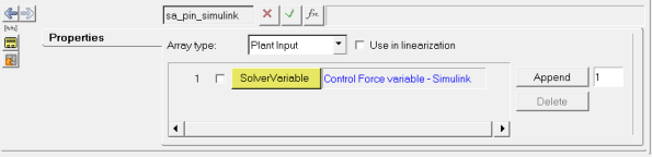

| Plant Input Simulink | Plant input | This Control_PlantInput element is used to define the inputs to the MotionSolve model |

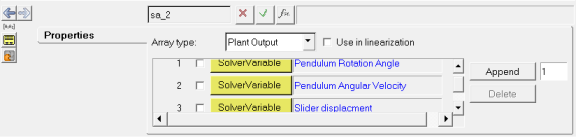

| Plant Output Simulink | Plant output | This Control_PlantOutput element is used to define the outputs from the MotionSolve model |
Figure 4. The Definition of the Input Channel to MotionSolve
Figure 5. The Definition of the Output Channels from MotionSolve
The inputs specified using the Control_PlantInput and Control_PlantOutput elements can be accessed using the PINVAL() and POUVAL() functions, respectively. Since the Control_PlantInput and Control_PlantOutput list the IDs of solver variables, these input and output variables may also be accessed using the VARVAL() function. For more details, please refer to the MotionSolve User's Guide.
This model has the following connections:
- Plant Input: A single control force that will be applied to the cart.
- Plant Output: The pendulum's angular displacement and angular velocity; the cart's translational displacement and velocity.

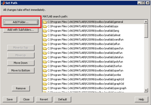

The core feature in Simulink that creates the co-simulation is an S-Function (System Function) block in Simulink. This block requires an S-Function library (a dynamically loaded library) to define its behavior. MotionSolve provides this library, but the S-Function needs to be able to find it. To help MATLAB/Simulink find the S-Function, you need to add the location of the S-Function to the list of paths that MATLAB/Simulink uses in order to search for libraries.
The S-Function library for co-simulation with MotionSolve is called
mscosimipc – for Inter Process Communication (IPC) using TCP/IP
sockets for communication. This file is installed under
<altair>\hwsolvers\motionsolve\bin\<platform>.
The location of this file needs to be added to the search path of MATLAB for the S-Function to use
mscosimipc.
This can be done in one of the following ways:
Use the menu options.
