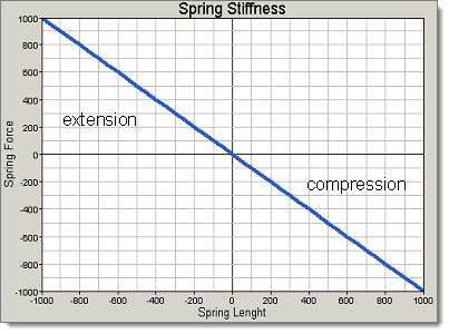

Spring Damper - Coil Spring- Stiffness
Verify that the independent variable does not contain a minus sign, "-",
in the expression. Figure 1.
Set the characteristic curve with same trend as the curve
below: Figure 2.

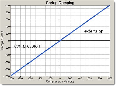

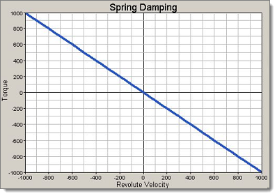

Spring Damper - Coil Spring - Damping
in the expression. By default, MotionView writes the independent
variable with a minus sign, `-{sd_.VR}`, instead of
`{sd_.VR}`, as required for a solver independent
model. Figure 3.
below: Figure 4.

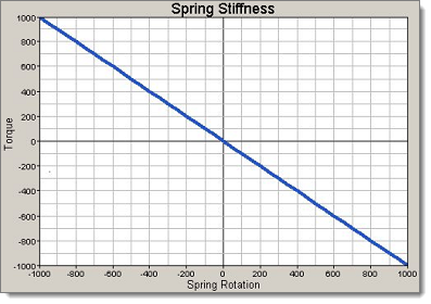

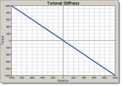

Spring Damper - Torsion Spring - Stiffne
variable with a minus sign, `-{sd_.AZ}`, instead of
`{sd_.AZ}`, as required for a solver independent
model. Figure 5.
below: Figure 6.

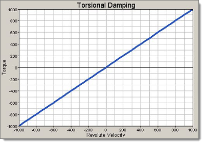

Spring Damper - Torsion Spring - Damping
Verify that the independent variable does not contained a minus sign, -,
variable with a minus sign, `-{sd_.WZ}`, instead of
`{sd_.WZ}`, as required for a solver independent
model. Figure 7.
below: Figure 8.

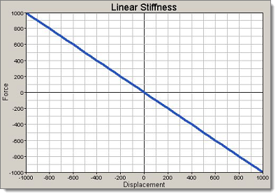

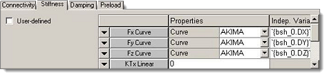

Bushing Elements - Translational Characteristics - Stiffness
variable with a minus sign, `-{bsh_.DX}`, instead of
`{bsh _.DX}`, as required for a solver
independent model.
This applies to the Y and Z direction as well. Figure 9.
below: Figure 10.

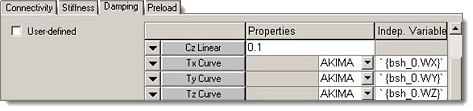

Bushing Elements - Translational Characteristics - Damping
variable with a minus sign, `-{bsh_.VX}`, instead of
`{bsh_.VX}`, as required for a solver independent
model.
This applies to the Y and Z direction as well. Figure 11.

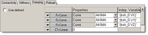

below: Figure 12.

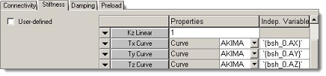

Bushing Elements - Rotational Characteristics - Stiffness
variable with a minus sign, `-{bsh_.AX}`, instead of
`{bsh_.AX}`, as required for a solver independent
model.
This applies to the Y and Z direction as well. Figure 13.
below: Figure 14.
