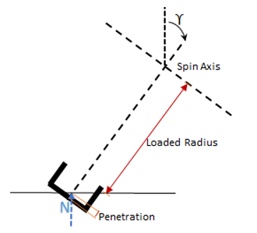

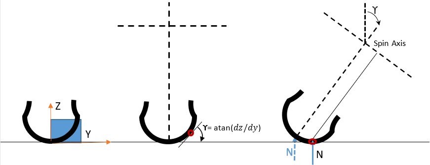

This is the default contact method that is used with the Fiala model. This model assumes the "disc" shape for the tire and rim and calculates the contact point at the intersection of the wheel plane with the road tangent.Motorbike tires have more curvature when compared with a car tire. At an inclination angle, the theoretical contact point shifts in the lateral direction. The geometry of the tire carcass is used to model this behavior.
Figure 1. From left: Tire cross section data needed for contact point evaluation | Tire at 0 camber angle | Tire at ϒ camber angle

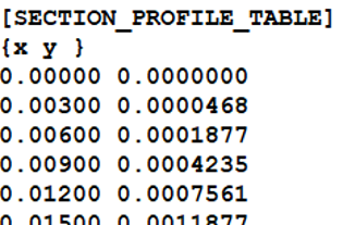

The SECTION_PROFILE_TABLE contains the data of the tire carcass. The table should contain two columns as shown below:
The {x y} in the above table serves as the label. The table is read as per the TYDEX-W coordinate system and it represents the height variation of carcass with respect to points along the carcass width. Data for only a quarter of tire carcass is needed as the tire is assumed symmetric about XY plane in ISO system. The data points should be monotonically increasing otherwise data points will be ignored and the tire contact with will be calculated assuming a rectangular tire carcass.

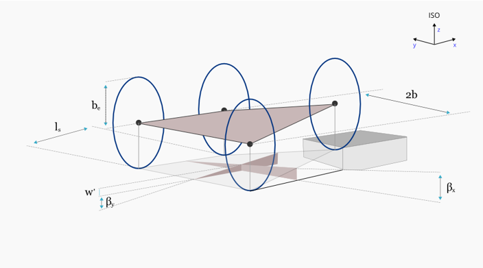

Elliptical Cam Contact Model
- Effective road height variation
- Effective slope variation
- Effective curvature
- Camber change
Figure 3. 3D Elliptical Cam Contact Arrangement

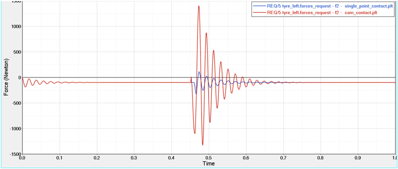

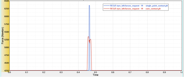

Figure 4. Vertical force at constant axle height when tire is rolled over a cleat (10 mm height, 50 mm length) at constant velocity of 10.833 m/sec (39km/h)
Figure 5. Longitudinal force at constant axle height when tire is rolled over a cleat (10 mm height, 50 mm length) at constant velocity of 10.833 m/sec (39km/h)
The results show that single point contact model predicts higher values of vertical force because it traces the obstacle, however the actual force experienced by the tire is less which is closely predicated using cam contact method.

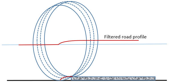

Figure 6. Filtered Road Profile Using a Series of Cams

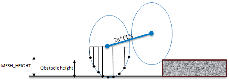

| MESH_HEIGHT | Height of the end points of the ellipse mesh. It should be greater than the obstacle height. |

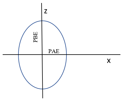

The equation for the shape of cam can be written as:
Figure 7. Cam Dimension
Figure 8. Cam with Two Point Follower
