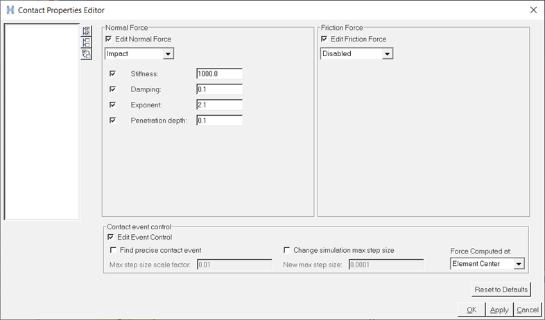

The Contact Properties Editor macro enables you to edit multiple contact force entities in a model simultaneously.
Figure 1. Contact Properties Macro

Normal Force
- Edit Normal Force
- Activate the check box to edit the Normal Force options of the selected contacts. This option is checked on by default. Activating this check box activates further options to change the normal force method and its properties.
Friction Force
- Edit Friction Force
- Activate the check box to edit the Friction Force options of the contacts. This option is checked on by default. Activating this check box activates further options to change the friction force method and its properties.
Contact Event Control
- Edit Event Control
- Activate the check box to edit the Event Control options of the selected contacts. This option is checked on by default. Activating this check box activates further options to change the event control properties.
Comments
- Selecting one contact entity brings up the properties for that contact. When selecting multiple entities, note that the displayed properties belong to the first selected entity.
- Changing to User Defined method for both Normal Force and Friction Force is not supported in this macro.
