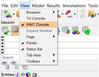

Launch the HWC Console
- From the View menu, select HWC Console to display the console.
Figure 1. HWC Console Entry Point
