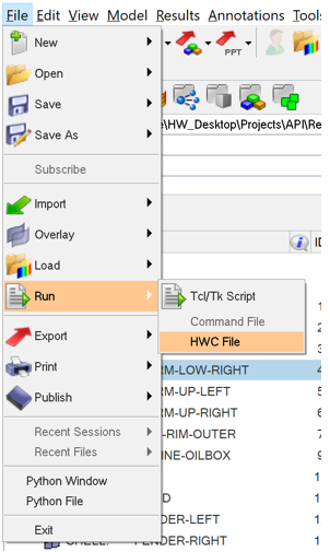

You can run HWC command files in the following ways:
File Menu Support
- From the File menu, select to execut the HWC command.
Figure 1. Run HWC Files from the File Menu

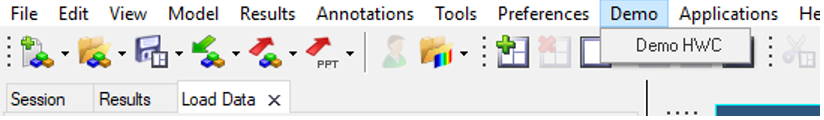

Custom Menus
Menus used to execute customized HWC scripts can be loaded from a customized preference file, preference.mvw. From the File menu, select to display the Preferences dialog. From this dialog, register and load the preference.mvw file.
*Id("HyperWorks", "20.")
*BeginDefaults()
*BeginGraphicDefaults()
*BeginMenu(dummy, "Demo")
*MenuItem(dummy, "Demo HWC", HWC, "c:/…./demo_script.hwc")
*EndMenu()
*EndGraphicDefaults()
*EndDefaults()The menu item is displayed in the menu bar:
Figure 2. Run HWC Files from a Customized Menu
