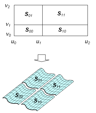

Composed surface geometry is defined by its patches. The parametric space of the composed surface is subdivided into the grid of rectangular cells with each cell corresponding to one of the patches of the composed surface. Depending on the location of the composed surface parameter in one of parametric cells corresponding patch is used to calculate the surface point for this parameter.
Subdivision of parametric space of the composed surface is defined by a set of grid parametric values for U parameter {uα} with index α taking the values in the range 0 … N and N is the number of patches in U parametric direction, and a set of grid parametric values for V parameter {vβ} with index β taking values in the range 0 … M and M is the number of patches in V parametric direction. For parametric values U and V such that
uα ≤ U ≤ uα+1 and vβ ≤ V ≤ vβ+1
the point on the composed surface is calculated as
S(U, V) = Sαβ(u, v)
where "local" patch parameters u and v are obtained by mapping from "global" parameters U and V using grid parametric values and patch parametric range values as
u = uαβ, 0 + (uαβ, 1 - uαβ, 0) (U - uα) / (uα+1 - uα)
v = vαβ, 0 + (vαβ, 1 - vαβ, 0) (V - vβ) / (vβ+1 - vβ)
