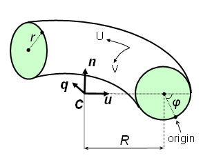

The torus is defined by a circular spine and a circular cross-section at each point of the spine. The spine of a torus is defined by a center point C, normal n, and radius R. The circular cross-section is defined by a minor radius r.
The torus is parameterized by angular parameters U and V. The V-parameter is the latitude with positive direction in the direction of the torus normal n. The value V = φ corresponds to the largest V-isoparametric circle on the tube of the torus.
The U-parameter is the longitude with positive direction in counter clockwise direction around the torus normal n in case the value of the parameter reverse_u is false. The direction of U-parameter is in clockwise direction around the torus normal n in case the value of the parameter reverse_u is true. The vector u defines the direction from the center of the torus C to the circle of constant U=0 parametric isoline of the torus.
The figure below clarifies the meaning of torus parameter and shows the fragment of the torus surface for the case when reverse_u is false.
The points on the surface of the torus can be calculated parametrically as
S(U, V) = C + r n sin(V-φ) + [ R + r cos(V-φ) ] [ u cos U + q sin U ]
u = U - n (nU) , n = N / | N |
The table below clarifies correspondence between torus parameters and parameters used by the function CreateSurfaceTorus.
| Parameters used by CreateSurfaceTorus | Torus parameters |
| origin | C |
| normal | N |
| uorigin_dir | U |
| base_radius | R |
| tube_radius | r |
| tube_phase | φ |
| reverse_u | If false then q = n X u, If true then q = u X n |
