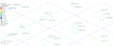

Option Description Regular Common data types like stresses and strains in the tensor format are shown with arrows (default). Shear components are drawn as opposing arrows in the plane in which they are acting. Shell element forces are recommended to be drawn in this mode also.

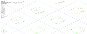

Figure 1.Moment Shell element moments are appropriate to draw in this mode.

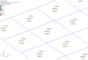

Figure 2.Crow's Foot Draws a plot of three vectors on a shell element (known as a Crow’s foot plot). Any three vectors can be chosen, however this mode is typically used to review in-plane loads on a shell element.
Figure 3. -
