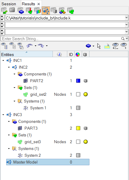

The Master Model is at the top level of the Include Files view. Data which does not have any references to an include file is stored in the master model. Each include file is represented with an icon along with its name, ID, color, and FE style. These extra columns can be turned off using the Configure Browser option.
Each include can be expanded to reveal its contents. The contents of each include is organized (grouped) into folders containing each type, next to which appears the total number of entities of each type. In the above example, the include named INC1 contains one include file INC2 (which contains one component, one set, and one system). Each of the folders can be expanded to review the individual entities in that folder.
