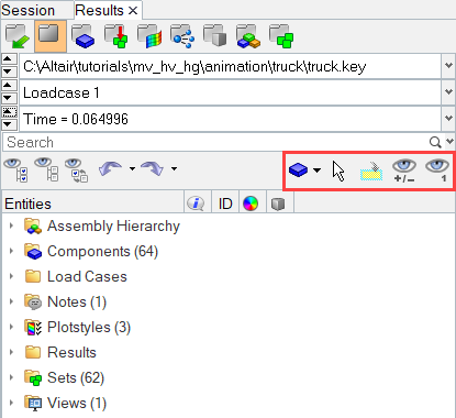

The Action Mode Tools allow you to turn entities' display on and off individually, isolate certain entities so that only they appear in the modeling window, or add entities to HyperView panel collectors.
The first icon determines the type of entity that you wish to manipulate, while the rest perform specific actions. The specific buttons available are Entity Type, Selector, Add to Panel Collector, Show/Hide, and Isolate.
