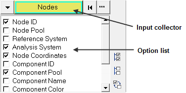

- From the Query panel, click the down arrow next to the input collector to select the entity type.
Select the entities to be included in the selection set.
- Click the Nodes, Elements, Components, or Systems input collector and use the extended entity selection menu.
- Pick entities directly from the modeling window using the quick window selection method.
The selected entities are highlighted in the graphics area.Note: Click the reset switch to clear the selection (all options). -
From the Options List, activate the check boxes for the information you would
like displayed in the query table.
The options available in the option list change, depending on the current input collector.

Note: For MinLayer/MaxLayer/ExtremeLayer, the query will return the layer name and the value.Systems System ID, System Pool, System Type, Origin Coordinates, X axis, Y axis, and Z axis. Note: Click the expansion button,
, to bring up the Query Fields dialog. This dialog
lists all the query options currently available (based on the current entity
type that is displayed on the input collector).Tip: Query options can also be selected, or deselected, using the All/None/Reverse buttons:
