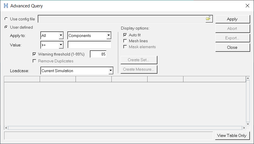

From the Query panel, click the Advanced button.
The Advanced Query dialog is displayed.
Figure 1. Advanced Query DialogNote: This option will only be enabled if a contour plot has been applied to the model.Tip: Part bound results are also supported in Advanced Query. Using Result Math to create expressions for part summations or max/min, the Advanced Query can be looped through the entire model and all loadcases to find the Top N/Bottom N ranked parts. -

If User defined is selected, use the Apply
to drop-down menu to determine the entities that the query will
apply to.
- All - Apply the query to all entities.
- Displayed - Apply the query only to the displayed entities.
From the second drop-down menu, select the entity type on which you
want to query.
Possible entity types include Components and Elements if the data type binding is elemental, or Components and Nodes if the data type binding is nodal.

Click Apply to apply your settings and start the
query.
The acquired data is displayed in a table. Based on the entity type, the table consists of different columns. Data can be sorted in the table by clicking on the header cells. When clicking on a colored cell, the corresponding component/node/element is displayed in the window.
