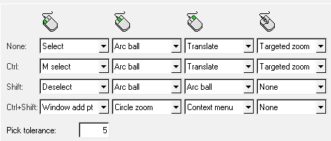

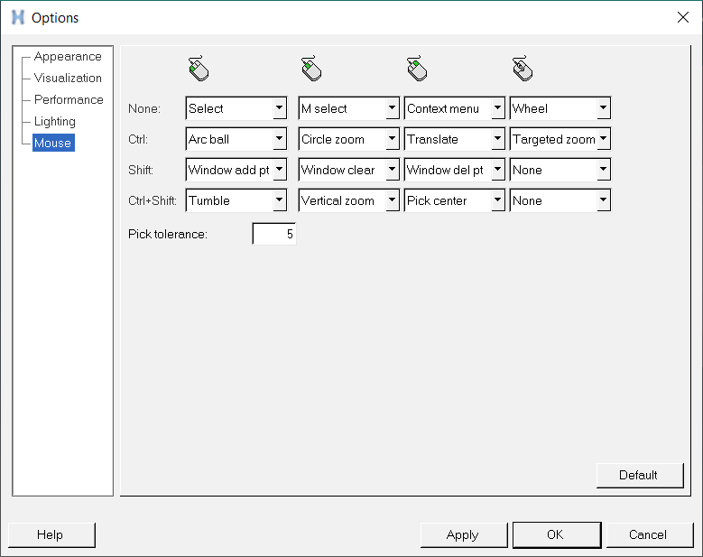

On the left side of the dialog box, None, Ctrl, Shift, and Ctrl + Shift are listed. If you select a function from the drop-down menu next to None, that function is enabled when you press the mouse button. If you select a function from the drop-down menu next to Ctrl, that function is enabled when you press the mouse button and the Ctrl key on the keyboard. Similarly, when you select a function from the drop-down menus next to Shift or Ctrl + Shift, those functions are enabled when you press the mouse button and the Shift key or the mouse button and the Ctrl + Shift keys simultaneously.
Pick Tolerance specifies the maximum distance, in pixels, that the cursor can be from a graphical entity in order to select it. When the pick tolerance is increased, it is easier to pick an entity.
Figure 2. Next Generation HyperWorks Mouse Settings
