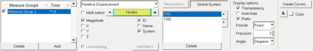

Figure 1. Measure Panel
Measure groups are displayed in the Measure Groups list. You can add and delete measure groups from the list. Check boxes allow you to activate/deactivate a measure group. You can also sort the items in the Measure Groups list by clicking on one of the list headings. In addition, keyboard shortcuts and a context menu are available for items within the list.
When a measure group is activated, it is included in the measure calculations and displayed on the screen. For each relative displacement or relative angle, the time step at which the measure was created is displayed as a reference. The definition of the currently selected measure group is displayed in the definition window.

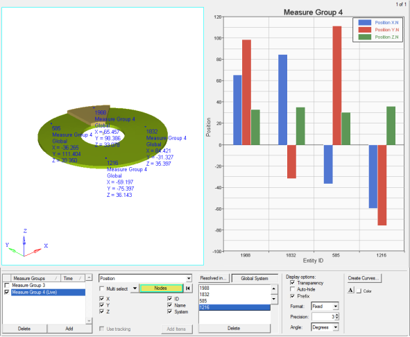

Figure 2. Example - Measure Group with a Bar Chart
