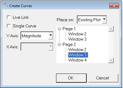

The Create Curves dialog is displayed.
Figure 1. -
Activate the Live Link check box to establish a link
between the selections on the Measure panel and the curve.
(Live) is added to the name of the measure item and the curve name to indicate that a live link is established. When a live measure item is deleted, a message is displayed prompting you to keep or delete the curve. When saving a report template with the live link option enabled, the curve is reestablished from a newly specified data file. The curve will be fully updated once a full cycle of animation is completed. A curve that is linked to a measure is updated when a tracking system is applied.
Activate the Single Curve check box to enable the X-axis
option. This option is only available for single entity measures.

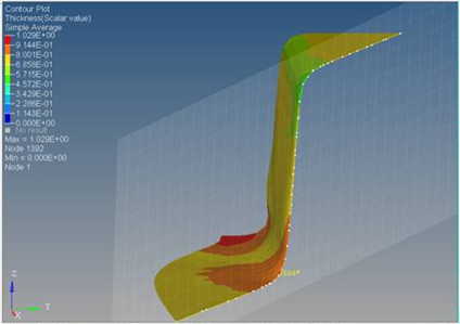

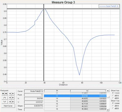

This option is only available for single entity measures (Position, Relative Displacement, Nodal/Elemental Contour, and Yaw Pitch Roll), and is particularly useful for plotting path measures of discrete selections.Note: This option will automatically be activated for all Node Path measures.Clicking on the measure curves within the HyperGraph Coordinate Info panel will highlight the entities in the HyperView modeling window.In order for the highlighting to work, the curves must be Live linked and they should also be created as either a Single Curve or from a Node Path. This is useful in identifying the entities at min/max of the curves points (see the example below):
Figure 2. HyperGraph Coordinate Info Panel (with max curve point selected)
Figure 3. HyperView Modeling Window (with node highlighted on the model) -
Select the Y-axis for the curve.
The available options depend on the group measure type.
Select the X-axis for the curve (if available).
Note: This option will only be available if the Single Curve option is activated.
From the Place on drop-down menu, select a destination for the curve.
Option Description Preview plot Allows you to review curves in a preview window. New plot The curve is created in the next available empty window. If no such window exists, then the page layout is changed to the layout with an empty window. If no empty window is found, then a new page is added. Existing plot The curve is created in an existing plot window that was selected from the page and window tree.
Figure 4.Y-axis Select a component of a measure to define the Y-axis in the plot. The available options depend on the measure group type selected.
X-axis Select a component of a measure to define the X-axis in the plot. The available options are: Distance, Entity-X, Entity-Y, Entity-Z, or Entity ID. With the X-axis option selected, the values of the abscissa of the curve will be updated at every time step for transient results, and at every frame for modal results with complex data.
The default setting for this option is Distance.
Note: If you are using the Modal or Linear animation mode with non-complex data, the value will remain constant throughout the period of animation. -
Click OK to create a curve in a preview plot, a new
plot, or an existing plot in a HyperGraph
window.
- If Preview plot was selected - a curve is displayed in the Plot preview dialog. Click the X in the upper right corner to close the dialog.
- If New plot was selected - a plot is created in a HyperGraph window. The position of the plot in the window is based on the next available page layout.
- If Existing plot was selected - a curve is added to the existing plot in HyperGraph (which was selected in the session tree).
