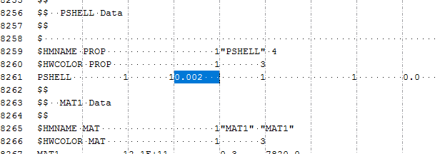

In the same line as PSHELL, highlight the value 0.002 for the PSHELL
thickness.
Note: In an OptiStruct deck, each field within a card is 8 characters long. Properly select the value for the PSHELL thickness by selecting 0.002 and the three spaces that follow.

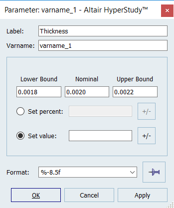

Figure 1. - Right-click on the highlighted fields and select Create Parameter from the context menu.
In the Parameter: varname_1 dialog, define the
parameter and click OK.
- In the Label field, enter Thickness.
- For the Upper Bound, enter 0.0022.
- For the Nominal, enter 0.0020.
- For the Lower Bound, enter 0.0018.
- In the Format field, enter %-8.5f.

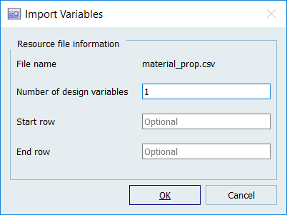

In the Import Variables dialog, specify the input
variables to import from the material_prop.csv file.
- In the Number of design variables field, enter 1.
- Click OK.
The Lookup model automatically populates the input variables based on the number you provided, and you can now identify the material by strings.

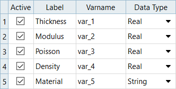

Figure 4. - Go to the Define Input Variables step.
Review the four input variables that were imported from the
beam.tpl file in the Parameterized File model, and the
one input variable that was imported from the
material_prop.csv file in the Lookup model.
Note: The label of fifth input variable has the same label as the first column in the material_prop.csv file, that is Material.

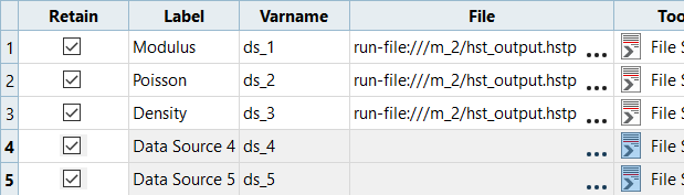

- Click the Data Sources tab.
Click Add Data Source to add two data sources.
Figure 6. -

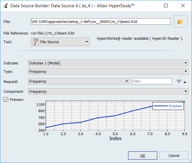

Define Data Source 4.
- In the File field for Data Source 4, click ….
- In the Data Source Builder dialog, File field, navigate to the approaches\setup_1-def\run__00001\m_1 directory inside your working directory and open the beam.h3d file.
- Set Tool to File Source.
- Set Subcase to Subcase 1 (Modal).
- Set Type, Request, and Component to Frequency.
- Click OK.

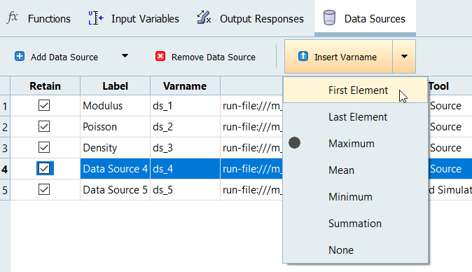

- In the Expression Builder, click the Data Sources tab.
- From the list of data sources, click Data Source 4.
Next to Insert Varname, click
and select First Element.
Figure 8. -
Click Insert Varname.
The Evaluate Expression field displays ds_4[0].
- Click OK.

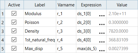

- Click Evaluate to extract the response values.
Figure 9.

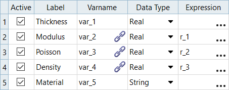

Link Input Variables and Output Responses
In this step you will establish links between the input variables imported from the beam.tpl file in the Parameterized File model with the output responses imported from the material_prop.csv file in the Lookup model.
- Click the Links tab.
Link the Modulus input variable to the Modulus output response.
- In the Expression field for Modulus, click ….
- In the Expression Builder, click the Output Responses tab.
- From the list of output responses, select Modulus.
- Click Insert Varname.
- Click OK to close the Expression Builder.
Create two more links.
- Link the Poissons input variable to the Poissons output response.
- Link the Density input variable to the Density output response.
Figure 10. - Go to the Test Models step and click Run Definition.
Click the Model Data tab and verify that the input
variables are equal to their corresponding linked output response.

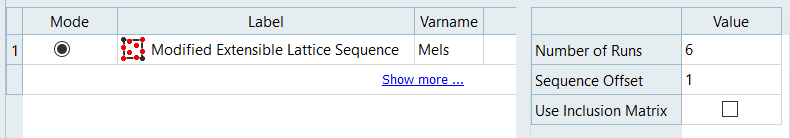

- Go to the DOE 1 > Specifications step.
Set the Mode to Modified Extensible Lattice Sequence
(Mels) and that the Number of Runs is set to
6.
Figure 12. - Click Apply.

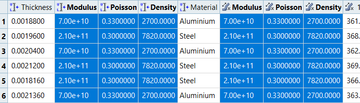

Click the Summary tab.
The output responses (material property numbers) from the .csv file are linked to the input variables (material property set in the FEA deck), and are now controlled in the categorical input variable Material.
Any number of material data can be added using a library, without requiring you to explicitly create “if” conditions in a .tpl file. This is the advantage of using Lookup model in this case.
