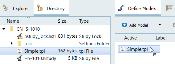

Review the Base Input Template
In this step you will use HyperMesh Desktop to review the base input template.

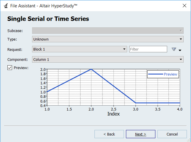

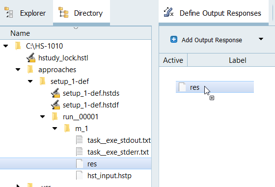

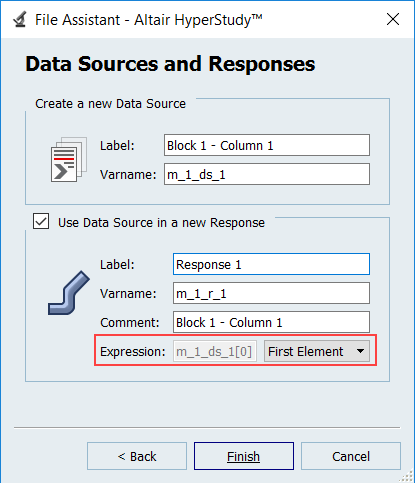

Create and Evaluate Output Responses
In this step, you will create two output responses.
