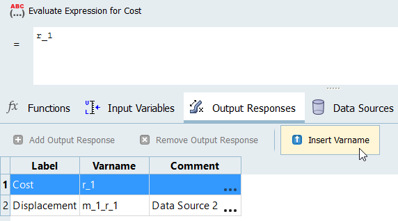

Figure 1. - Select existing functions, input variables, output responses, or data
sources from their corresponding tabs and click Insert
Varname to append its corresponding varname in the Evaluate
Expression field.Note: When inserting a data source, click ⏷ to select a common operation to map the data source to a scalar number (for example, maximum or minimum).
