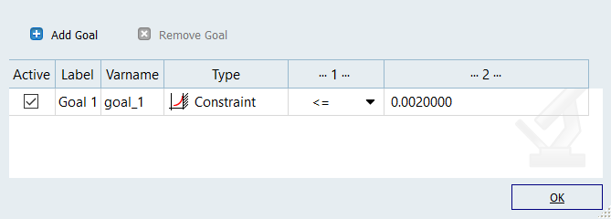

In the Goals column, click
A dialog opens. - In the Type column, select the type of goal to create.
- In columns 1 and 2, define additional options as needed.
- Click OK.
Figure 1. -
