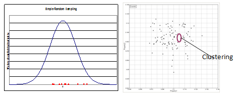

The conventional approach of sampling is commonly called Simple Random or Monte Carlo. In Simple Random sampling, a pseudo-random number generator is used for generating random numbers from 0 to 1.
Usability Characteristics
- The statistical measures (such as mean or standard deviation) of a random sample group requires large numbers of runs to converge the given probability distribution’s statistical measures.
- A correlation structure can be specified to reflect the correlation existing between random variables. Applying a correlation structure can be costly for a large number of input variables.
