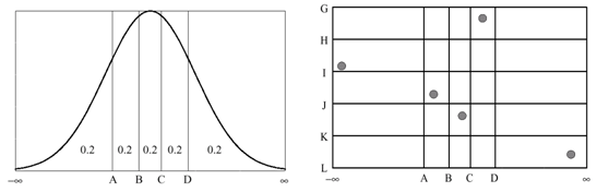

The Latin HyperCube method uses a constrained or stratified sampling scheme.
- The range of each random variable is divided into non-overlapping intervals on the basis of equal probability.
- One value from each interval is selected at random with respect to the probability density in the interval.
- The values thus obtained for are paired in a random manner with the values of . These pairs are combined in a random manner with the values of to form triplets and so on, until k-tuplets are formed.
Figure 1. Latin HyperCube Sampling
