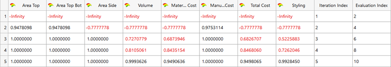

View Cross-Validation R2 History Summary
View a detailed cross-validation R2 history summary of all output responses in a tabular format using the R2 History tool.
