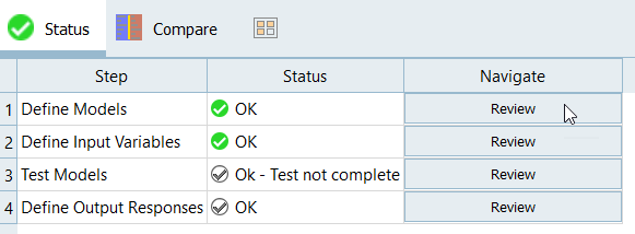

Review the status of a Definition to verify that each step is
complete.
Go to the Definition step.
Click the Status tab.
The work area
displays a status of each step in the Definition.
Navigate to a step in the Explorer by clicking
Review from the Navigate column. Figure 1.

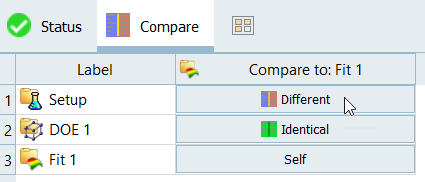

Compare definitions
Compare a Definition with others in the study to identify which are
identical or different.
Click the Compare tab.
The work area
displays a list of Definitions in the study, and indicates
which are identical or different.
From the Compare to: column, click
Identical or
Different. Figure 2.

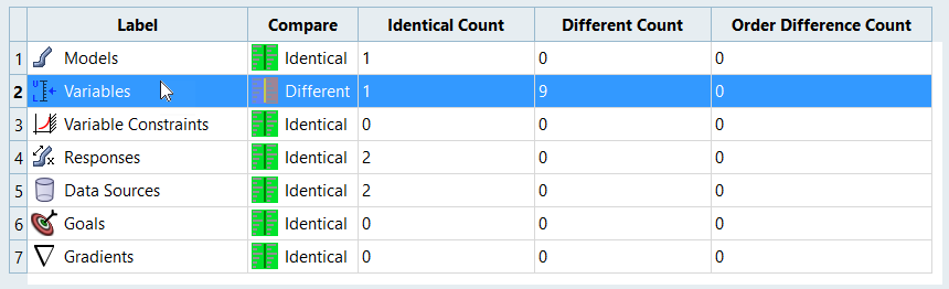

The Compare Definitions dialog opens.
A list of the different types of channels used in the study is
displayed, along with a count of all instances found to be
identical and different.
Click a channel to display a detailed comparison. Figure 3.
