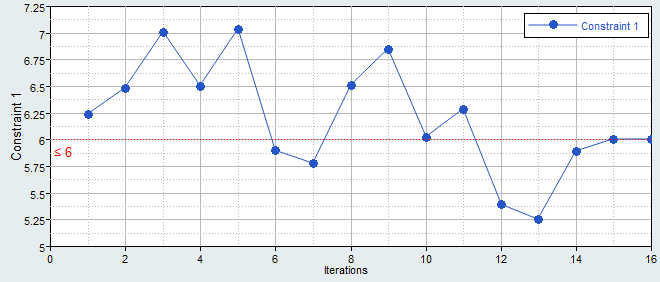

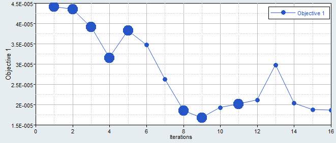

Analyze Iteration Plot
Plot the iteration history of a study's objectives, constraints, input variables and unused output responses in a 2D chart using the Iteration Plot tab.
Figure 6. Objective History
Figure 7. Constraint History
