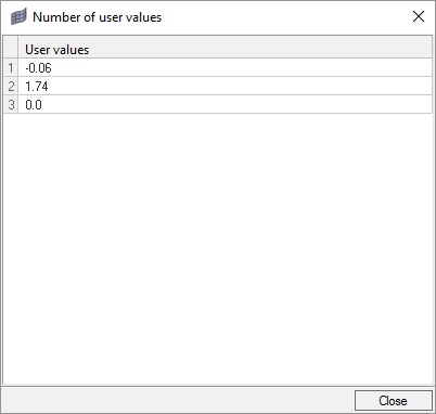

The body force in the x-direction is given by the expression:
- Α = Amplitude of oscillation = -0.06 m
- ω = Frequency of oscillation = = 3.6 rad/sec
- T = Time period of oscillation = 1.74 sec
- φ = Phase difference = 0

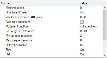

Set the Analysis Parameters

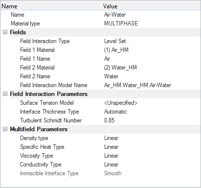

Create a Multiphase Material Model

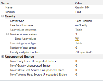

Set the Body Force

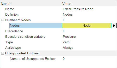

Assign the Reference Pressure

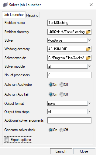

In this step, you will launch AcuSolve directly from HyperMesh and compute the solution.
Run AcuSolve
