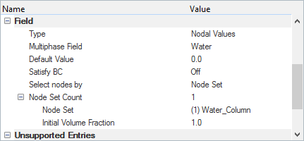

Set the Nodal Initial Conditions
Assign Nodes to the Node Set

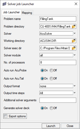

In this step, you will launch AcuSolve directly from HyperMesh and compute the solution.
Run AcuSolve
