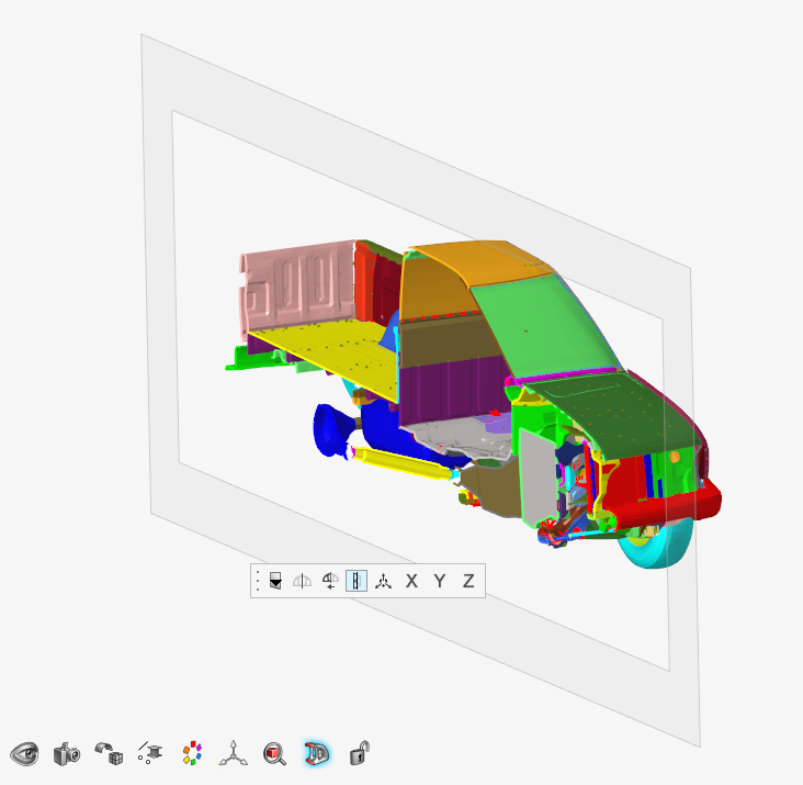

- Section Cuts
- Cross Sections are now editable inside and outside of the Section Cut tool in HyperWorks. Drag the frame to translate or the inner edge to rotate.

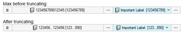

- Improved formatting of selector labels
- Single named selections now also use the consistent format “name/label
[id]”, and can now abbreviate name and id independently when exceeding
maximum display length.

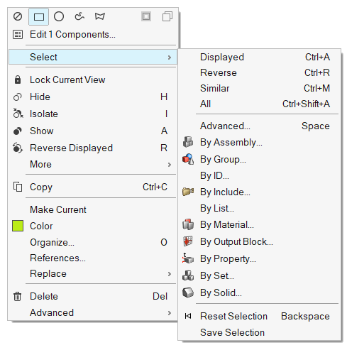

- Simplified right-click Select menu
- Removed additional sub-menus in HyperWorks
so all available selection methods and actions are now available
directly under .
