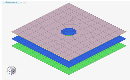

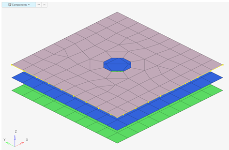

- Connector Line
- Connector Seam lines and Spot Lines have undergone changes to improve
how they capture significant geometrical points along the connector. See
images below. Pre-2021 displays how the connector has a test point on
either side of the corner. 2021 displays the significant point on the
corner.
Figure 1. Pre-2021
Figure 2. 2021 - FEMFAT Spot Welds
