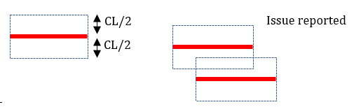

- Clearance_Zone (CL)
- Clearance value will be assigned on the CAD data during the intersection
check. Half of the value will be assigned on each side of the CAD data.
Increasing the value might increase the execution time.
Figure 3.
