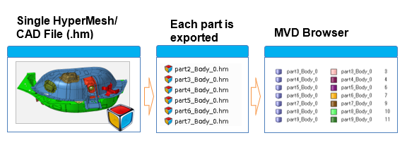

- readMultipleParts
- A single CAD file will be the input. Each part inside the file will be physically separated and exported to create part structure.
