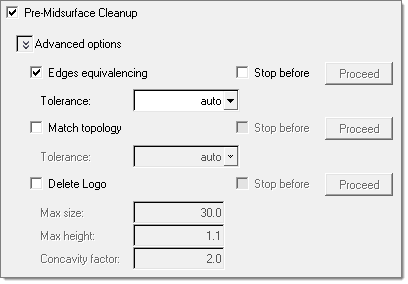

Select Pre-Midsurface Cleanup to define pre-midsurface
cleanup options.
- To equivalence edges on the input surface, select the Edges equivalencing checkbox. Edges can be equivalenced using an automatic or manual tolerance.
- To fix gaps between stitched edges and vertices to make the actual geometry of the surfaces consistent with the model topology, select the Match topology checkbox. Topology can be matched using an automatic or manual tolerance.
- To remove logos that appear on geometry, select the Delete logo checkbox. This is based on settings from the parameter file.
Figure 2. -
