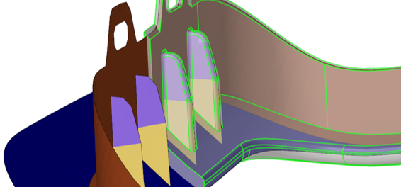

Midmeshing

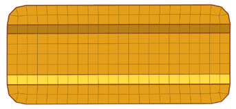

Automatically generate a mesh at the midplane location, directly from the input geometry (components, elements, solids or surfaces), without first creating a midsurface.
Figure 1. Midmesh Result Example
The resulting output consists of 2D shell elements created with the user-provided target size, as well as 1D elements defining the topology of the mesh (vertices/edges/faces). Midmesh generation is also multithreaded to take advantage of multi-core environments.

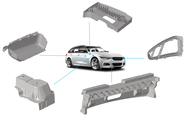

Direct Midmesh Supported Parts
Figure 2. Direct Midmesh Supported Parts

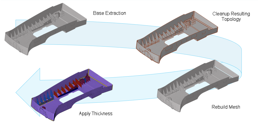

Midmesh Generation Workflow
- Base Extraction
- Extract the base midmesh.
- Cleanup Resulting Topology
- Use the semi-automated midmesh editing tools to correct the 1D topology and fix any bad/missing faces. The goal is to prepare the model for final remeshing.
- Rebuild Mesh
- Remesh to the final flow and quality using the rebuild mesh functionality, and correct any remaining mesh quality issues.
- Apply Thickness
- Map the thickness from the original solid to the midmesh via the Map Thickness tool.
Figure 3. Midmesh Workflow

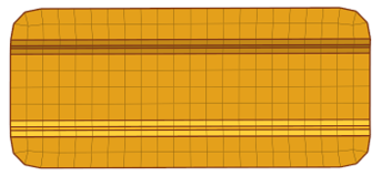

Option Action destination comp Select which component newly created midmeshes are placed in. ignore flat edges Do not imprint flat edges from the input geometry to the midmesh.
Figure 4. Option Disabled

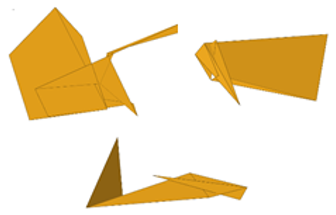

Edit Midmesh
Once the midmesh is generated, there may be problem areas that need to be corrected.
Select the edit edge subpanel access tools which can be
used to repair 1D topology edges.
Option Action create mid-edge Create a new mid-edge, optionally using the input geometry as a guide.
Figure 14. Before
Figure 15. Aftersplit by two nodes Create a new edge between two nodes.
Figure 16. Before
Figure 17. Aftersplit by node-edge Create a new edge between a node and an edge, using a shortest, tangential or mixed path.
Figure 18. Shortest Path
Figure 19. Tangential Path
Figure 20. Mixed Pathdelete edge Delete an edge.
Figure 21. Before
Figure 22. Aftert-edge align Align/flatten a t-connection edge to a surface.
Figure 23. Before
Figure 24. Afterby geom edge align Align mesh edges to input geometry lines and smooth the mesh.
Figure 25. Before Align
Figure 26. After Align -
