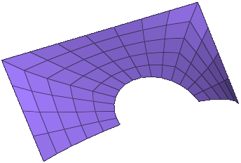

Import the model containing the new mesh into HyperMesh.

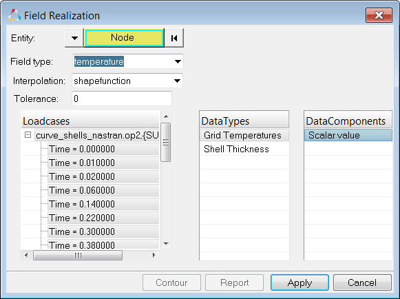

In the Field Realization dialog, define the realization
settings:
Figure 2.- With the Entity selector set to Node, select the target nodes (nodal temperature loads) that you would like to map.
- Set Field Type to temperature.
- Set Interpolation to shape function.
- Under Loadcases, select the loadcases you would like to transfer. Each load case selection will create a new load.
- Under DataTypes, select the temperature.
- Under DataComponents, select scalar values or displacement x, y, and z values.
Click Apply.

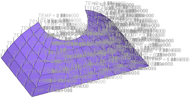

Temperatures from the result file are now mapped to the new mesh.
Figure 3.

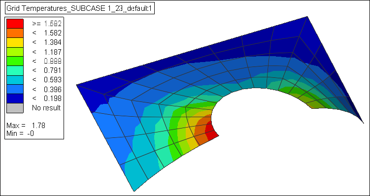

Click Contour to view the contour for each load case
(select the correct load case).
