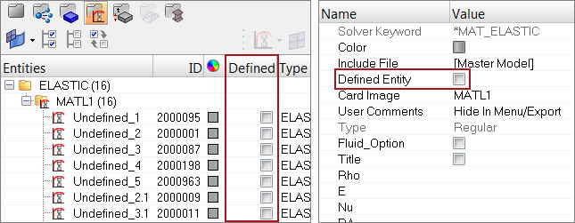

- If Defined is inactive, the entity not will be written to the solver deck.

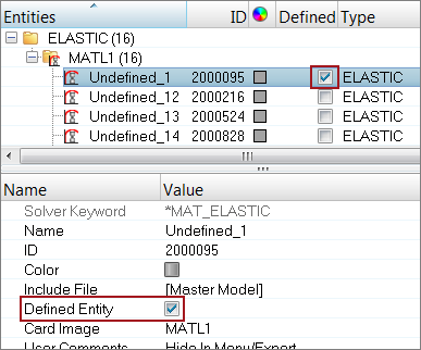

- If Defined is active, the entity will be written to the solver deck.
The export status of undefined entities cannot be changed. If Defined is inactive, the export status will also be inactive in the Entity State Browser.
Resolve Undefined Entities
Undefined entities can be defined interactively in the session or via the import of a model that contains the referenced entities. This ensures the entity will be written to the solver deck.

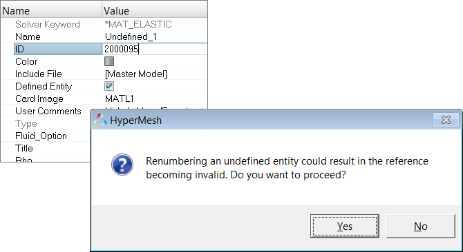

Renumber Undefined Entities
The renumbering of undefined entities is restricted to ensure references to entities that reside in external Include files will not be invalidated.
